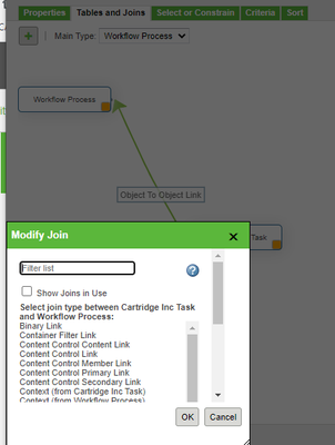

I am trying to link a "Workflow Process" to its Change Task.  I can't get it to show the Task information.
This is what I have so far.
Do I need to have an intermediate link to something else?
I am trying to link the Task to the Workflow Process.  The reason I need the Workflow Process is some of our workflows were not fully completed.  It's due to someone not taking something into account when creating the workflow.  I have a situation where the ECN shows Resolved, the Task shows as Resolved but the status of the Workflow Process still shows as Running in the Routing/Process History table.
I am trying to create a report with a criteria that says the Status of the process is Running but the ECN Task is Resolved.
I can get the report to show the Workflow Process but I can't get it to show the ECN Task.  The columns are blank for the Task Name and Number.

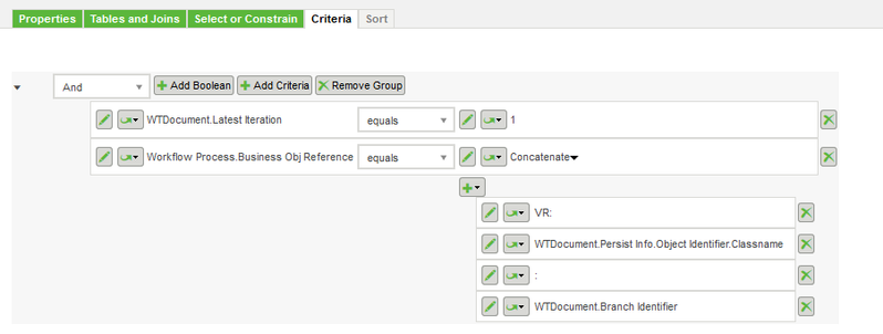

Hi Steve,
you can try to specify a criteria instead of using OOTB joins... take a look at this, it is an example for joining WFProcess with WTDocument:
Regards

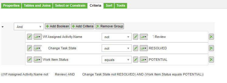

@BrianToussaint That worked Brian.  However, I am getting multiple entries of the same ECN #.  How can I remove the duplicates?  On the Properties page the Distinct and Group By boxes are grayed out.  Just for the heck of it I added Latest Iteration set to 1 on the Criteria page but that didn't work.
@imendiola Iker, that is a little too complicated for me.  I'm no expert.  I know enough to get by on the easier reports.
@STEVEG - I only have the distinct checked.  It has been a while, but I know that sometimes it is difficult to get that checked. I also have Expose report checked.  I do have the following criteria also set up, and I do not know if that will help or not.
That's not helping but at least I got a report.
It shows one entry for each of the Tasks roles.
