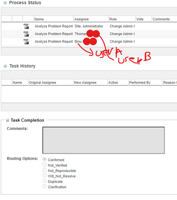

I have the following problem, when I start as an orgadmin I create a Text Document and start the Problem report. When I look in the Problem report workflow i ve put as Change Admins I 3 participants: orgadmin, user A and user B. I sign in as user A i can see the problem report but can't approve the same as user B. I can approve only as orgadmin. For user A and B the routing options are grayed out so they can't bring any decision like Fast track approval, clarify, reassign etc... but i want also approve as user A and user B why is that not possible?
Hey Marco i've solved the problem, the solution is as follows: I deleted the organisation from the users accidently so they are not participating in a organisation so they don't have routing options shown in picture:

User A and B can't finish the task, but I ve put user A & B as change admins I role they can see the problem report but approval option is grayed out. User A has the Windchill advanced licence and user B has the Basic licence

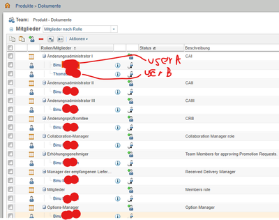

I am doing simple problem report. So I've already put the users in the Team and created a txt file that will go trough problem reporting, Binu (user A) will be the one who is going to approve the problem report. When i log as Binu (user A) the routing options are grayed out eventhou he is Change Admin I. I 've put some pictures for better understanding

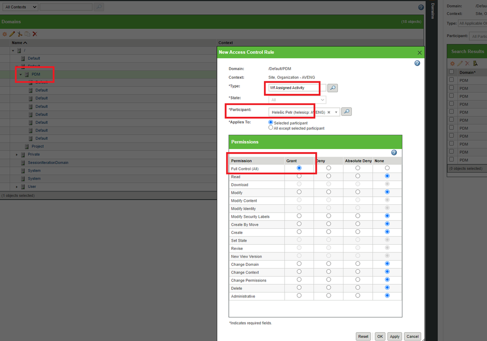

Go to the Policy Adimistration add a new ACL for specific user and specific object type (the workflow Task ) add full control and check if the user can finish the task.
The point is that there can be private access on private domain. or another domain .
Administrator need to play with ACL for the specific user on different levels to find the correct one.

what if I give a specific user full permission on WT Object, will he be able to approve then? I am doing this for experimental purposes
HelesicPetr
(To:EC_10581209)
Try it you will see.
PetrH

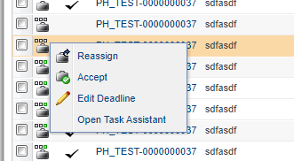

I've given the user Binu full control of WT Object but still the Task Completion is grayed out when i log as user Binu, that should not be or am I mistaken?

i've put the user on Site as Change Admin for Problem reports
but the options are grayed out still

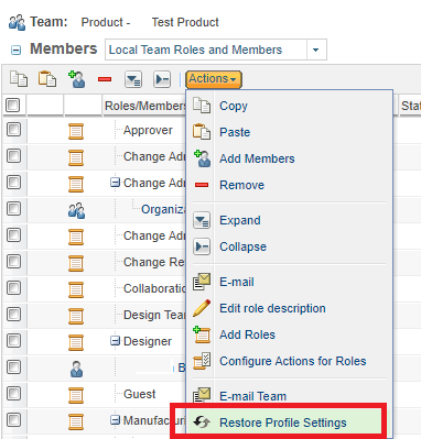

Try to go to a product team and restore profile settings
PetrH

i've purged the users cache and restored profile settings and checked the actions for the roles (see pic)
but it is still grayed out

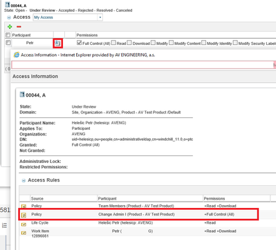

Please check also access on the Problem Report for the user
PetrH
got the role Change Admin I with full control
HelesicPetr
(To:EC_10581209)
@EC_10581209
so the user did not have the correct acl rights based on the missing organization
