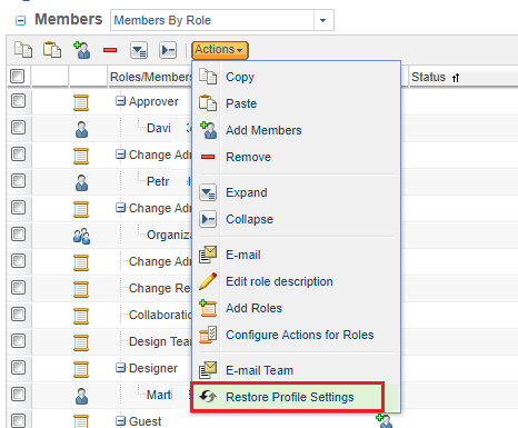

I remember that it can case some internal cache and additional settings on the context
go to the team and try to reset the profile settings
you need to do it on each context
it can solve the issue

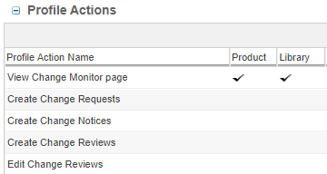

First: you have to make sure that you have the right License profile assigned. Windchill Base and greater licenses have change management included but ThingWorx Contribute (for non-CAD) and view licenses don't. You can either check this from Site/Profiles or from Site/Participant Administration and then checking under your account. Both of these assume you have admin access. You're looking for "Create Change Notice" or whatever change object you're interested.
This is from base:
Meanwhile, this is from a contribute license profile:
If the license profile you have assigned doesn't allow for change notices, stop here and contact PTC or your VAR to get the right license first.
If the correct license profile is assigned, then make sure that you don't have multiple ones assigned that would be conflicting (I ran into this a while back). If you have a Base license AND a Contribute license it will end up being that the more restrictive option will be enforced... at least that was my experience. So, second: make sure that you confirm that of the license profiles you have assigned to your account you don't have one that would allow for change notice creation and then a different one that wouldn't. Remove the one that doesn't give you the capability you need.
Third: This was my issue, above. Standard profiles are also at Site/Profiles or Org/Profiles and these just further hide actions that the user has permissions for via license profiles but you don't want to enable for that particular group. I use this specifically to allow read/write access to particular attributes to a subset of users. Here, make sure that your "Create Change Notice" option is also checked. I did have to uncheck the option for change notices and then turn it back on.
