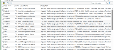

Using the attached QML, I was able to retrieve the users assigned to their respective licenses. However, the report is also returning the associated team roles along with the license or group names to which the licenses are mapped.
Do you have any suggestions on how to exclude all team roles from the report? Although the criteria section technically allows filtering out roles, it is not practical to identify every possible role and create separate criteria entries for each one.

try this ,I used a dummy trick , all license groups starts with PTC:

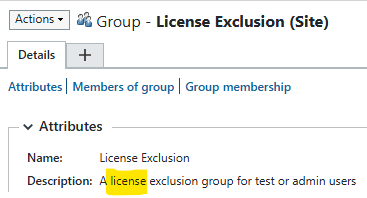

FYI: To include all PTC license groups, including those not beginning with PTC (e.g. License Exclusion and Platform Structures), filter groups where their description includes the word 'license'.

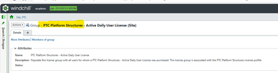

license exclusion is not a license group ,and  its intended to be used only for admins to test actions.
the "platform structure" that you mean  is also not a license one , the license platform license one has well  PTC in its name :

License Exclusion is used in any scenario where a user account should not count against licensing.  That includes any person with multiple Windchill accounts (training, development, business configuration testing, dual-role administrators, etc.), and headless accounts used to connect PTC products to PTC products (e.g. publishing administrator).  Third-party integration accounts must be licensed.  Always follow up with PTC to ensure they haven't recently changed account licensing requirements.
Then there are scenarios where a user is a member of License Exclusion and a member of a 'PTC*' license group.  These need to be sorted out.

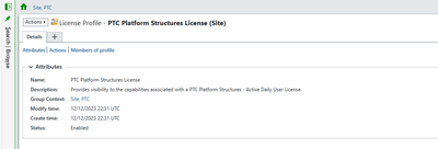

Platform Structure has been deprecated for a while - replaced with PTC Platform Structures.  It still exists in Windchill systems and should not be in use, but we can't assume it doesn't still have users assigned to it.  If it is empty, it won't show in the results set.  If it is not empty, it's appearance in the results set prompts the report user to clean it up.

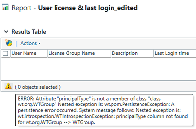

1. The report complained that PrincipalType doesn't exist.  It doesn't prevent loading of the report in 13.0.
That attribute was added in 13.1.    Just need to remove the attribute from the Select or Constrain tab before running the report in 13.0 or earlier.
