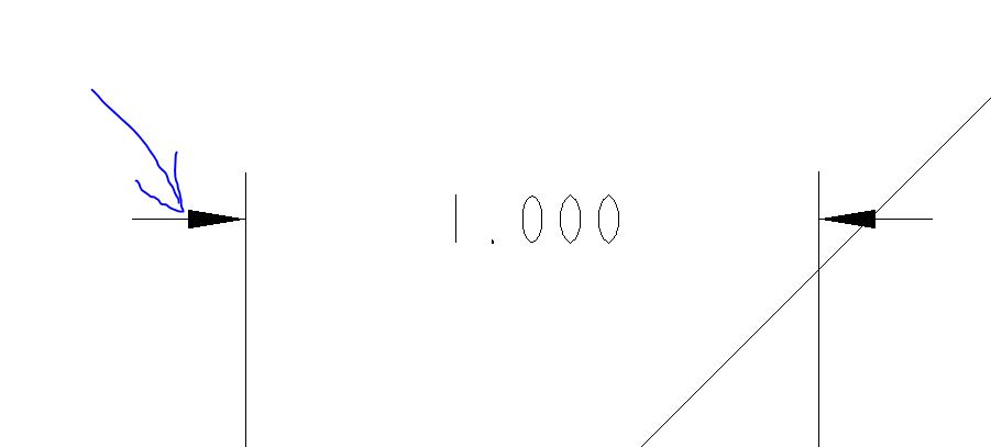

I am using Creo 2.0. When using dimension in drawing mode the tail length of the dimension arrow often is too long. Here I am referring to the dimension arrow which does not have the dimension label attached to it.
Is there a way to set the arrow tail length for a single dimension?
And is it possible to delete one or both dimension arrows?
Thanks in advance.

Hi Frederik,
I you meant dim leader (tail) length, it can be changed by the the detail option dim_leader_length,
I don't believe we have option to change the leader length for single dim.
We can easily delete the dimension arrow by going to annotate (tab), format (group), Arrow Style (command), selecting none & picking the arrows need to be deleted
regards
Pushkar

Hi Frederik,
regards
Pushkar

Thanks for the help Pushkar.
I can't find the dim_leader_length option in the config.pro. I have tried using "find" or "add" but it does not appear. Do you know why it is not accessible? Or is it possible to set the dim leader length somewhere else?
Best regards
Frederik
July 11, 2016
dim_leader_length option is available in the Drawing Detail file and not in config.pro
use  File/prepare/drawing properties and select the Change for the Detail options.
Anyhow you can't change the arrow length for a single dimension.
