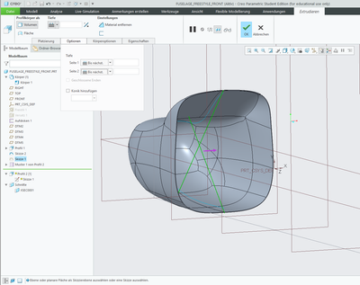

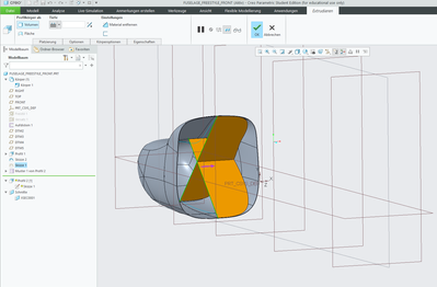

Im trying to extrude up to this inner Surface with a certain amount of clearence. Untill now im only getting it extruded up to the nearest Surface. Normally i would select the Surface i want to extrude to and set an offset, this doenst work here somehow.
If i try do choose the Surfaces i only can select one.
If i try to select "extrude to the nearest surface" in both directions it doesnt work either. If i split it into 2 seperate extrudes it works, meaning extrude one side first and create another one for the second side.
Hope someone can help me.

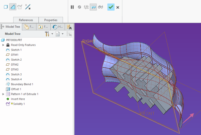

I am suggesting you create the ribs to overfill the quilt then cut the ribs to size using the solidify feature to cut the ribs to size.  He is an image of an offset quilt being used to cut a patterned rib.

When using surfaces as a depth reference for a feature it is preferable to select the quilt option as it will be more robust. Internal IDs can change for surfaces and the quilt option is more stable due to this.  Try setting the selection filter to quilt when selecting the depth reference.
If you need an offset value for the depth then you can create a copy of the quilt that is offset and use that as the depth reference.

What im trying to do is create a ribstructure inside this hull that has an offset to the inner surface of the complete hull. Hope this makes sense.

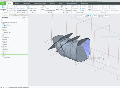

JV_9087269
(To:tbraxton)
How can i share the .part file so that you can open it ? 
In this picture you can see that i made two offset surfeces, one for the inner top surface of the airfoil and on for the inner bottom surface. I can select those when extruding between them, because they are one continious surface. But when i try the same with the hull i need to select more than one surface to be able to extrude a rib along the entire inner surface

I would do this all in surfaces.
  1. Go to insert model immediately after the freestyle surface
  2. Make a copy of all of the surfaces of the freestyle feature (this should make a quilt). Do this by setting the selection filter to quilt and use CTRL+C CTRL+V to copy and paste
  3. Offset the quilt from step 2 by the desired amount (this will be your depth reference quilt)
  4. Create your ribs and select the offset quilt of step 3 as the depth reference (your ribs can be solid)
Your rib structure should project within the bounds of the depth reference quilt. There are exceptions to this requirement but you should follow this when possible.

Typically if you want to extrude up to a set of surfaces, you need to make a copy of those surfaces, creating a single entity quilt of those surfaces.

I created the hull using the freestyle tool and thickened the surface. Making a copy of those surfaces doesnt make them one surface. I tried merging them, but the option is grayed out.

Creating a copy of several surfaces makes a quilt. You can extrude up to a quilt.  You can not extrude up to multiple surfaces of a solid.
To select the quilt, change the selection filter to quilt or use query select (right click till highlighted then left click to select).

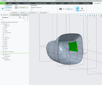

JV_9087269
(To:kdirth)
Oh yeah that worked. I selected all the surfaces from the thickened hull and copied them. Then i could select the copie when extruding. Another problem i have now is that my pattern wont work. Is there a way to get the pattern inside the hull?

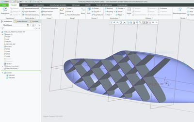

for what you seem to be trying to accomplish, I would suggest making your ribs (extrude to a distance) before thickening the quilt, then cut them with a copy of the quilt.
JV_9087269
(To:kdirth)
How can i cut the thickend quilt with the ribs ? With Boolean ?
kdirth
(To:JV_9087269)
I would send you a sample but it seams PTC has decided that Creo 7 student versions can not open commercial files.
JV_9087269
(To:kdirth)
Thanks a lot ! This is exaclty what i needed.
