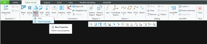

I have a 3D frame model and I want to add mass to a point to locate the CG of a component.  The Help section says to use the Refine Model --> Mass function to do this, but I haven't been able to locate that function on the Ribbon, or in any of the Toolbars.  Where is this located?

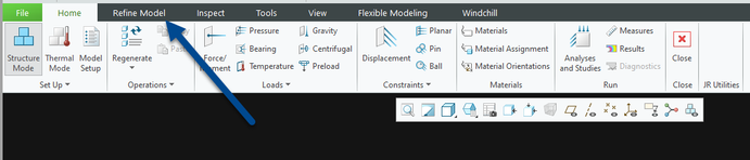

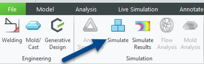

The article you linked is referencing the Simulate application. This is used for FEA.
Bummer.  Unfortunately, I don't have Simulate.  I didn't realize that's where I was copying the link from.  Thanks for the quick reply.
