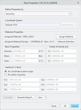

I have a 3D frame model and I want to add mass to a point to locate the CG of a component.  The Help section says to use the Refine Model --> Mass function to do this, but I haven't been able to locate that function on the Ribbon, or in any of the Toolbars.  Where is this located?

This pointed me in the right direction.  Thanks.  I was trying to assign mass to a datum point, but apparently I can't do that.  I tried to create just a point in a sketch and assign mass to that.  I can't finish the sketch, because it's just a point.  So I created a sphere and assigned the mass to that.  Then I'll locate the masses in the assembly to give the total package the necessary weight distribution.

Sorry for the long delay in replying.  I went back to this topic this morning to see if I could implement what you were talking about.  I'm not sure that I follow.  I'm looking at the mass properties for one of my components.  I just created a sphere to represent the object in my assembly model, and I tried to assign a mass of 13,300 lbm to the object.  But, The inertia values aren't correct.  I made a solid block roughly the size of the engine, and the calculated mass using steel is within 300 lbs of the actual weight.  The inertias look much more realistic.  I can't figure out why I can't input the mass at a CG and come up with an equivalent inertia.
Mass sphere
Block mass
Thanks in advance.

The box represent 1 kg of water.
The size is 100x100x100 mm^3 with a density of 1g/cm^3 this equals to 1 Liter  10cmx10cm10cm = 1kg
Now I want that the weight is 5 kg
Alternate from  GEOMETRY to PARAMETER
PRO_MP_ALT_DENSITY enter 5 times more 0.000005 kg/mm^3 (PTC does not change this to the assigend unit g/cm^3 🙂
After Calculation (weired sh%$) the model weights now 5 kg if used in one Assembly.
You can do the same with all the other parameters.

Thanks for the tip on this.  I didn't know that you could set alternate mass properties like that.  I was trying to do it a different way.
