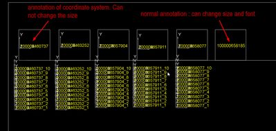

When I create a coordinate system in a layout (I use to place components automatically in the assembly), I can not change the text font and I can not change the name of the coordinate system.
This behavioral is present only by coordinate system.
Do you have some advices for me?
Thank you!

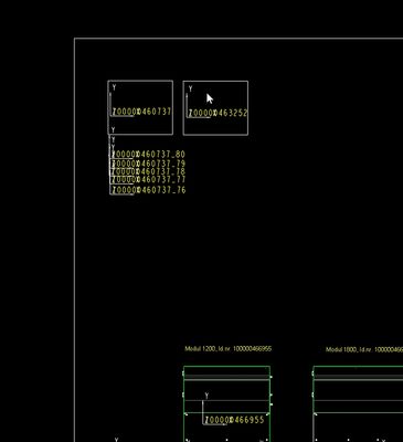

My question is according JUST in LAYOUT /now called Notebook/.

I created new notebook in Creo Parametric 7.0 and set detail option named default_annotation_font.
Notes and CSYS names are displayed in font I set using this option.
OK! Nice! Thank you! For new notebook is working. Some ideas how to apply this to "old" one?

I got it with the font. Annotations are not the problem. Always I speak about the "annotation text of a coordinate system in notebook". The problem with the font is done! Thank you.
Now is still the problem with the font size of "annotation text of a coordinate system in notebook". I can not change it. In not so important issue, but should be interesting to know if it possible to mage it.
Of course the problem with no changing of the name of "annotation text of a coordinate system in notebook" still be.
I guess the size of CSYS names is hardcoded and cannot be configured. Please ask PTC Support to be sure.
