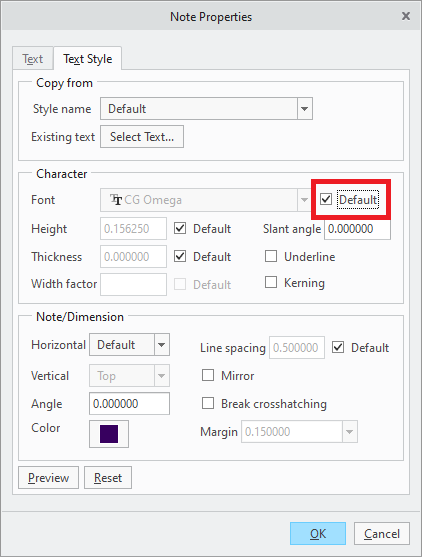

I created new notebook in Creo Parametric 7.0 and set detail option named default_annotation_font.
Notes and CSYS names are displayed in font I set using this option.
Martin Hanák
OK! Nice! Thank you! For new notebook is working. Some ideas how to apply this to "old" one?
New created annotations are with the new font, but the existing annotations do not get the new font 😞
www.pi-engineering.at
I think existing annotations have font assigned manually. Edit note properties and turn on Default option.
Martin Hanák
