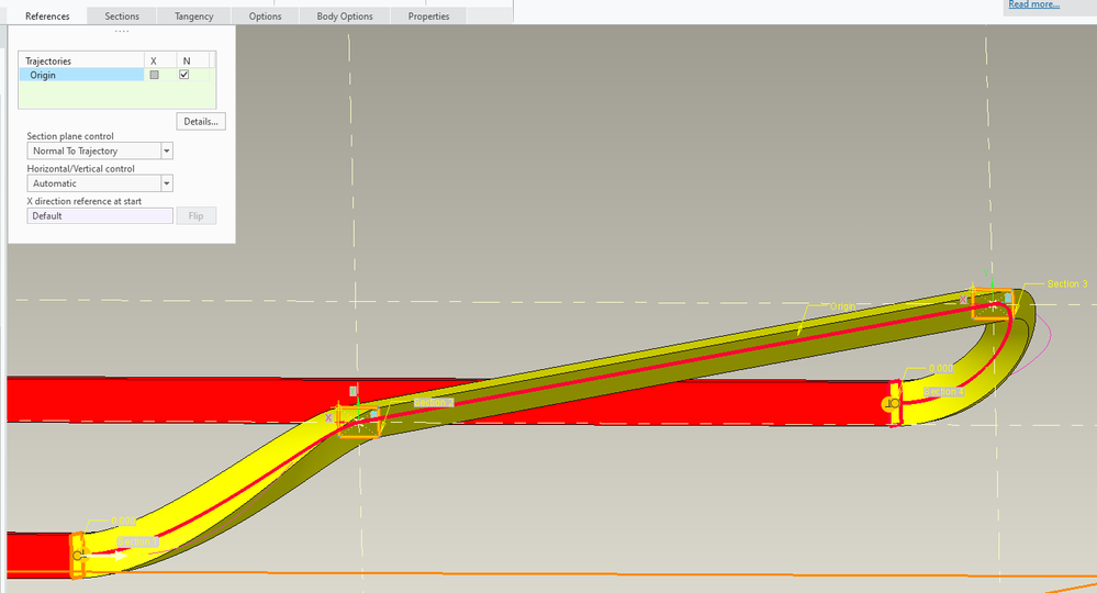

Set "Section plane control" to "Normal To Projection" in sweep References.
And set datum plane witch will define orientation for sweep section.

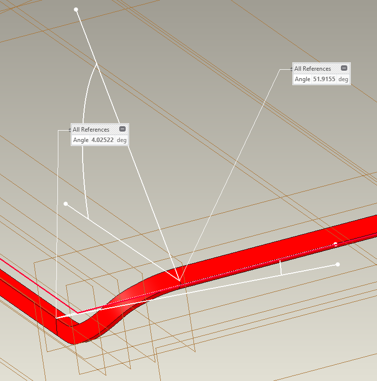

@Van_AG thank you , but can you please be more specific? I have about 25 planes in this design, I know you don't see them.
That rectangle must be rotated 90 deg, so the angle that now has 51.9155 deg should have 90 deg and the other one should have 0 deg.

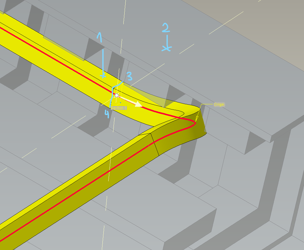

I'm not sure which datum plane to pick as it doesn't generate anything when I do. It doesn't allow me to sketch the profile anything when I do.
Which planes to pick?Which planes to pick?
1 must be parallel to 2 and right angle between 3 & 4. The turn to bottom left must be flat as well, with the bigger surface on the top.

Please see the attached models.
Trajectory segments "Intersect 1" and "Intersect 2" not tangent to neighbors, so I recreate them in r3-model

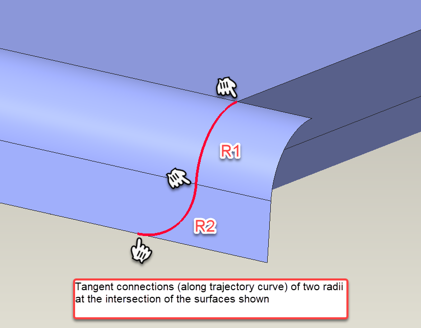

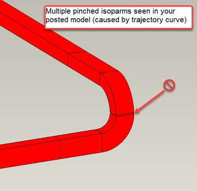

I would encourage you to create a new thread specific to your model and issue. I have posted here an example of how to manage the trajectory of the corners which I think provides what you are looking for. In general, one would like to have a minimum of G1 (tangency) continuity along the entire sweep trajectory. With less than G1 continuity in the trajectory it usually results in undesired geometry when used for sweeps.
I have enclosed a model (Creo 4) where I have "managed" the corner transitions in a way that imposes tangency such that you can use the sweep normal to trajectory option to get a "good" corner transition. Note the corner has a single tangent transition where the two radii meet in 3D space.

Illustration of corner control using two radii. This paradigm can of course be implemented for splines and 3D curves (ISDX) to get a desired transition in the corner as well. It is possible to impose continuity at G2 and G3 in some cases if needed.
