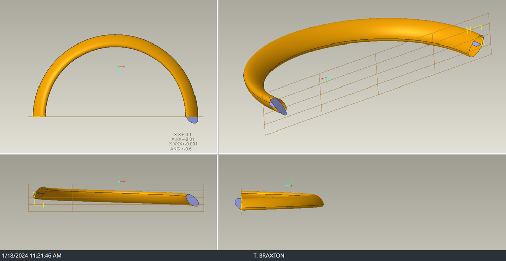

There is a circular face and I want to create a helical sweep (like a spring) from it. However, the origin circular face is angled such that it is not normal to the helical trajectory.  Currently using Creo Parametric version 8.

tbraxton
22-Sapphire I
(To:ptc-4929481)
Does this appear to represent the desired geometry?

ptc-4929481
(To:tbraxton)
It looks close but hard to tell exactly from the pictures. I understand that approximation can be made by directly projecting the circular face curve onto the normal section, but it will not be accurate since in reality it is a rotating projection. An exact geometry of non-normal face protrusion is needed in this situation. Can you share the geometry if that is the case? Thanks!

KenFarley
(To:tbraxton)
I was similarly perplexed. It seems to be an attempt to represent the result of a flat endmill cutting along a helical path?
ptc-4929481
(To:KenFarley)
Yes, Ken, The design intent is exactly to reproduce the result protrusion/cut of a flat endmill making a helical path cut.

I looked at it, still not enough info to describe what you want,
Is something like this what you're trying to do, just with a helical trajectory instead of an "S" trajectory?
Your picture shows a cutting face with a fixed normal orientation. I have attached an assembly with a Creo design intent file, and a desired step geometry which was created using some other software.
In looking at it, it almost looks like a simple helical sweep with an elliptical cross section normal to the trajectory just with the ends cut at weird angles to create a circular end (did it real quick and got very close).  If the section normal had flipped or radically changed along the trajectory the shape would have transitioned and gotten circular, or at least radically thicker along the trajectory, but it didn't.  Still not enough info.
