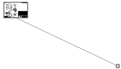

When I move a balloon around, it runs away. I was to move it onto a snap line, however, the balloon fled so far away. I am not sure what it was worried about. There must have some constraints in its mind driving the balloon always run away. How to prevent this time-consuming "catch&flee" cycles?
Just now I found an acceptable solution: 1) toggle off "Snap to Guides"; 2) move the deserter back to its position.

Occasionally I get this issue also, it's pretty rare but infuriating when it happens. It's as if the move point is at some arbitrary location way off the balloon. And every time you move the balloon, it seems the move point gets farther away.
I don't remember how I get around it. Seems like I delete the balloon and re-add it.

Hello @JS_9824412
For sure "data specific", and not "generic" behavior.  Without accessing data to investigate this further therefore, it's difficult to give guidance.
I see 2 possible root causes:
  • Drawing Model (the asm) somehow corrupted. If so:
    • Recreating a new drawing in a similar way will reproduce the issue (this may be a good test to confirm that root cause is in the 3D Model, and not in the drawingà
    • Maybe check Model Size of the given assembly to check if you eventually see an abnormal high value (compared to model geometry of components assembled inside)
  • Drawing View Corrupted
    • I see more chances to be so
    • If so:
      • update_drawing all in Drawing Setup file may help?
      • Recreating a new View and Creating Balloon on this new View will help (choose for this > Create Balloons - By Comp & View menu)?
If nothing helps above, Is it possible to simplify a lot the assembly, ensure issue persists, and backup a simplified version of the drawing here (to avoid sharing confidential data)? If yes, we may try to have a look, and if not resolving this in the contect of impacted data, maybe trying to provide a workaround.

Just now I found an acceptable solution: 1) toggle off "Snap to Guides"; 2) move the deserter back to its position. (Note: If the "Snap to Guides" is turned on, PTC still can help by disclosing what the parameter is to control the distance of running away.)

Check out the Delivered reply to this Idea:  Option to disable/turn off annotation leader snapp... - PTC Community
Besides the check box there is a configuration to set:  annotation_snap_to_guide_range - off, 1, 3, 2, 4, 5

We had this issue, along with views moving, caused by a shrinkwrap in the assembly that had been modified after the drawing was created. the modified shrinkwrap was a different size and this 'moved' the view centers on the drawing which caused them and balloons to move.
