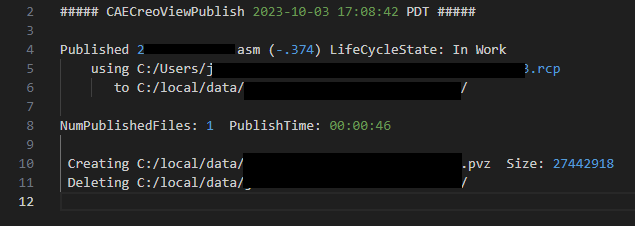

When # is not 0, how can I actually read what those errors and/or warnings are? I tried generating a log with the published PVZ, but the resulting log is fairly unhelpful, simply stating what was published, where it was published to, and with which recipe file.
