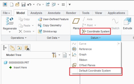

There are two types of coordinate system features in Creo - the normal "Coordinate System", and the "Default Coordinate System".  Creo reserves this internal "Default Coordinate System" - that always set the same orientation.
Basically, Creo always needs something to use as a reference. So, the first feature in your tree can either be:
  • a "default" csys
  • three datum planes
If the first feature in your model (or your "start part") is a coordinate system - it will actually create a "Default Coordinate System", because there is nothing else in the part to use as a reference.
If you want your start part to use a coordinate system with a different orientation, you can define your datum planes first, then create a regular coordinate system to orient  it differently.

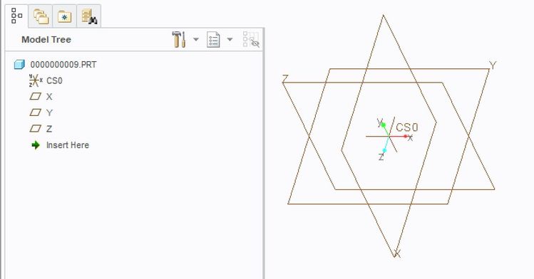

aka - if you create your "coordinate system" (and then three datum planes), you will get this:Capture.JPG
If you create your datum planes first, and THEN your coordinate system, you can create something like this as you desire.rotated.JPG
Note how the blue-green-red are matched to different axes than in the first example, and I've simply renamed the datum planes.
However, a VERY important thing to note: even if you create your "first" coordinate system as I showed in the second example.... if you create a "Default Coordinate System" now, it will ALWAYS create it with the same orientation as in example 1, and you will not be able to edit it's definition.
If you ever want to "change" the orientation of the part... one thing you can do is to create a NEW coordinate system rotated from the "Default". Then you can use "Replace Reference" to  change all of your features to use the new coordinate system/orientation instead of the old default one (then maybe hide or delete the default... of course, depending on your company standards, etc).

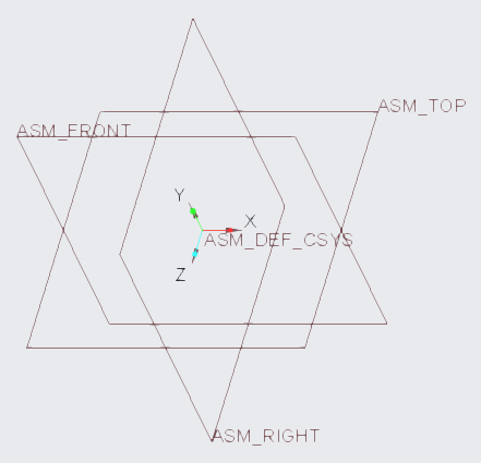

Creo Parametric 5.0 5.0.3.0 release (New version upload has coordinate system oriented with Z AXIS up).
Has anyone else encountered this?
Since we started teaching and writing books on PTC products (1994), the Z axis always projected out from the FRONT datum plane.
Now it goes up from the TOP datum plane.

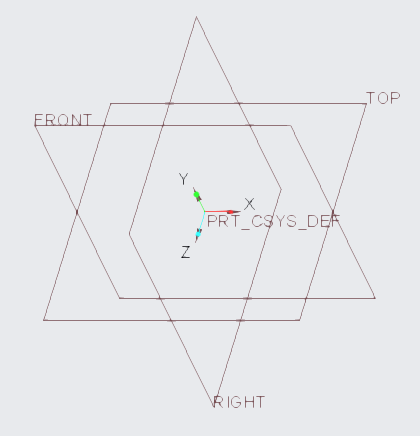

The major problem with that picture is that the positive side of the front plane is pointing opposite the positive direction of the Y axis.  Based on the coordinate system orientation the gray (negative side) of the front plane should be visible, not the brown (positive) side.
TomU
(To:lglamit)
@lglamit,

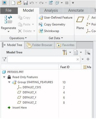

I just installed Creo Parametric 5.0.3.0 and I cannot reproduce this.  Here's what I'm seeing:

This is based entirely on the start-part template that you use. Technically speaking, you could rename all of the datum planes to X, Y, and Z, or change any of the names from TOP, RIGHT and LEFT to whatever you want.
So PTC may have updated the "out-of-the-box" start part to fix the naming convention (I haven't double checked it).. but there are a lot of template start parts you can pick from scattered across the installation (for example, there are some in "Common Files\templates" and others in "Common Files\creo_standards"). As for Z pointing "up" (on your screen), this may actually have to do with the "Default" rotation/view/orientation as well.

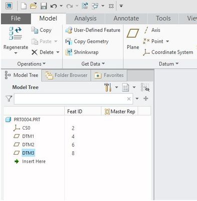

Personally, I typically like to create my own start parts anyway by first creating an "EMPTY" part (File->New->Part - uncheck "Use default template", select "Empty) and then creating an empty model with whatever datums I'd like. In this case, as I mentioned earlier, CS0 is considered a "default" csys (aka, no possible way to redefine it), white DTM1, DTM2, and DTM3 represent your X, Y, and Z planes respectively. From there, you'd also need to create your default views (FRONT, RIGHT, LEFT, BOTTOM, etc), so it can be sort of painful the first time around... but once you have it put together, it's a beautiful thing - (we even have some code that helps us build them automatically from scratch Smiley Wink )
Taking it one step further, I personally like to group those features, and make them "read only" so they don't contribute to the model regeneration, and so that they are out of the way from any new users who may want to try to modify them.... but that's a little outside of the scope of what we're talking about in this thread Smiley Happy
