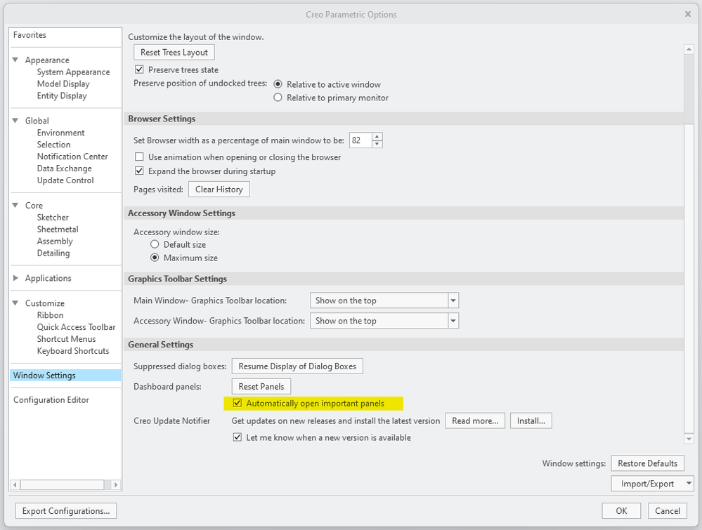

One Creo 9.0 question:    I'm super excited to use Creo 9.0 and can't wait to see what's next for Creo 10.... In Creo 9.0 many/all of the dialog boxes are by default open.  is there a config option to go back to previous versions... off.    I sure would like to be able to doc the saved draft analysis.   I see with the new style dialog boxes that we are heading in that direction.

I'm not sure what you're referring to when you say all the dialog boxes are open..?

@bbrejcha,
Uncheck 'Automatically open important panels' under 'Window Settings'.
