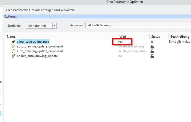

Hi Martin,
couldn´t rest until i have a acceptable solution. So I serach again and tested the config.pro option ALLOW_SAVE_AS_INSTANCE,
because I want to see what happen with new created instances in the family table. 🤔
If you switch it to YES , use "save as" and confirm "New Model" (not "as a family table instance") the colors won´t change.  Maybe Creo run the right way in this mode when creating new parts from instances.

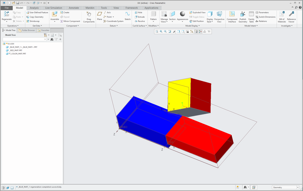

I cannot reproduce your problem in Creo 4.0 M120. See attached picture and xx.asm.

1.]
I am able to reproduce your problem in Creo 4.0 M120 and also in Creo 5.0, 6.0, 7.0.
From my point of view it is a bug, so you can report it to PTC Support. But I'm afraid that they will tell you that Creo is working properly...
2.]
After testing I found a trick that solves your problem.
Step 1: Save assembly instance as temporary standalone assembly.
Step 2: Make a copy of temporary standalone assembly.
Step 3: Delete temporary standalone assembly.
See uploaded video.

Hi Martin,
Greetings
Kai H.
who would have thought that allow_save_as_instance YES would have an impact on saving instance as standalone model.
Option description (no mention of an standalone model...):
no*, yes
Allows the option to save a copy of the active model as a family table instance.
Martin Hanák
never thought this is a solution. But when you becom desperate 😉, you catch every straw in hope to solve a problem. In the end "trail and error" is the last method of work.
