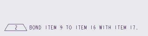

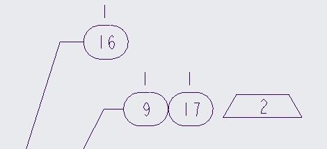

Does anyone have a way to reference boms in a drawing note? I would like to make my drawing note intelligent so if the BOM changes my notes do also.
i.e. Bond item (rpt.index) to item (rpt.index) with item (rpt.index).

Hi ptc-292364, I try to answer (sorry for my english).
I tried this method but I'm not sure if it will work for you.
-I created an identical copy of the table (with the same SORT REGION as the main table).
-In the new table in repeat region I created a relationship (I use PTC_COMMON_NAME to recall the UNIVOCAL name of the detail in the table):
if ASM_MBR_PTC_COMMON_NAME == " UNIVOCAL NAME"
COUNT1=rpt_index
ELSE
COUNT1=""
ENDIF
-Then I added a column to the new table and inside I inserted the report parameter rpt→rel→user defined→ COUNT1
-At the bottom of the new table I added a row.
-Inside the cell of the new row and new column with repeat region →summation →add→by name→COUNT1 I have inserted a new variable (pippo1) which sums up the values of the new column.
-I used &pippo1:d to get the rpt_index value for the note.
-I repeated everything (in relationship with new if and COUNT2) to get a new variable pippo2 corresponding to rpt_index of different detail.
-I've hidden the copy of the table in a layer.
