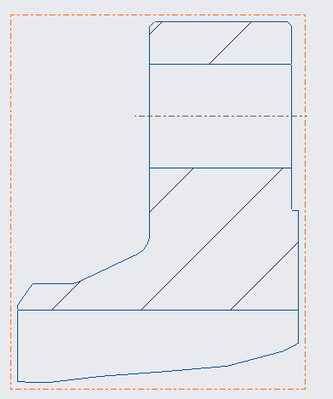

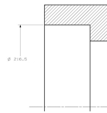

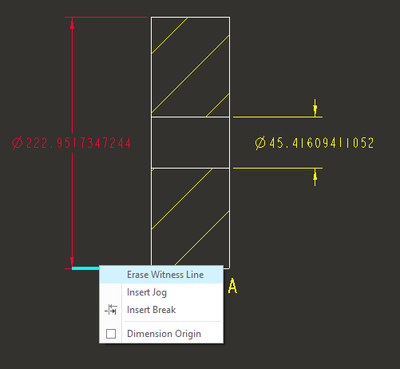

Hello.
How do I show one -sided diametral dimension in Creo drawing application as shown below?
Best regards,
Sergey
StephenW
(To:Sergey)

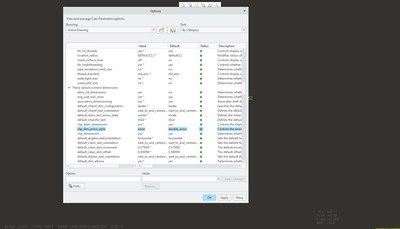

Select the witness line you want to remove then RMB erase witness line.
Depending on your drawing settings, you will get different results. If you need to, go to file - prepare - drawing properties - detail options change
and set the option clip_dim_arrow_style NONE
then you can "drag" the "none" arrow side to however you want it.

It is not so simple.
I have made a Detailed view of a cross-section. Center line isn't there to create a diametral dimension. Any thoughts?
StephenW
(To:Sergey)
Show your dimension from the model OR create your dimension in the main view and move it to the detail view OR temporarily change your detail view boundary to include the centerline, create the dimension, then re-sketch the boundary as desired.
Sergey
(To:StephenW)
Hello again.
Thanks for help. It worked.

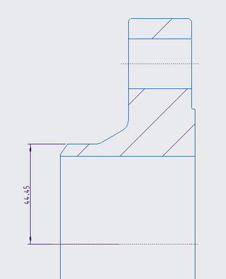

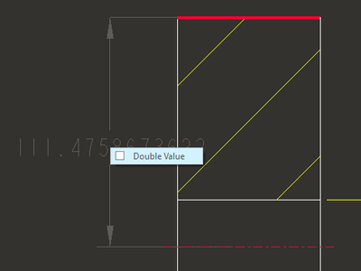

One more question, if I may:

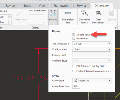

How do I convert linear dimension into diametral?
StephenW
(To:Sergey)
If you've already created it, select the dimension, then in the ribbon, select DISPLAY, then "double value" toggle box
If you are creating it, RMB just before placing the dimension and the "double value" option is there.
You have to add a diameter symbol

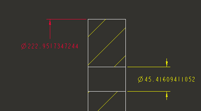

JS_9824412
(To:StephenW)
It works. Thanks for the teaching.

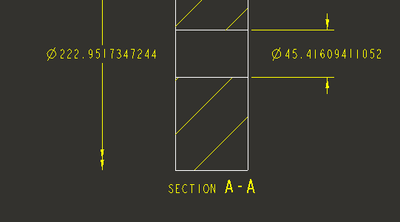

(However, there is still some bug in CREO 6, as shown in below snapshot. One dimension is right, the other is wrong)
