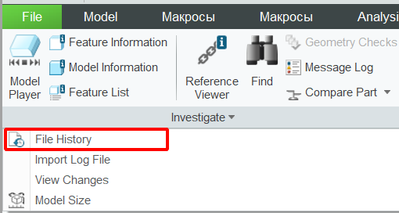

About the date. Did you know about "Tools - Investigate - File History" tool?
Steto
(To:YaroslavSin)
Dear Ysintsyn,
I was not aware of that tool, I will check it out. Thank you very much.
