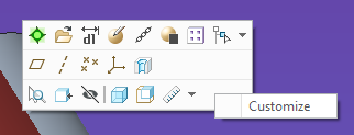

RMB on tool bar and select Customize:
Search for Transparent and drag to toolbar:

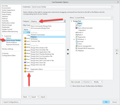

If you are asking about adding a mapkey to the tool bar, you can go to file options and add them to a quick access toolbar.

I have a map key I created a few years ago, but now also have transparent and solid added to the quick access tool bar.  If i click on a part the button is right there.
Hi Kdirth,
If you don't mind me asking, how did you get the Transparent added to your quick access toolbar?  I'm using Creo 4.
So true!  Every day is a learning experience with Creo 😁.

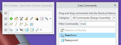

Hi Kdirth,
Thank you, thank you, thank you!
Mike
