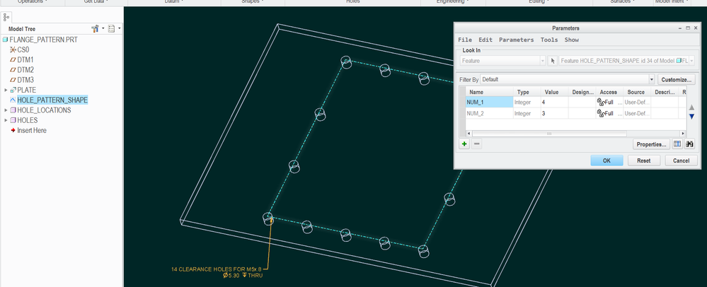

Well, your case intrigued me and I came up with this solution:
You can place a point at some distance along a curve.  Then this can be turned into a dimension driven pattern of points.  And pattern relations can be employed to produce different spacing for the different side lengths of the rectangle.  The end result is a single hole pattern that is driven by the sketch feature:
Notes:
- in this implementation, couple of parameters defined in the sketch feature specify how many "spaces between holes" exist on the long and short sides of the rectangle
- there is still a need for 2 patterns because you can't use points on curve as the basis of hole placement.
Feel free to adapt the attached Creo 2.0 file to suit your needs - and if you can, please share any improvements.

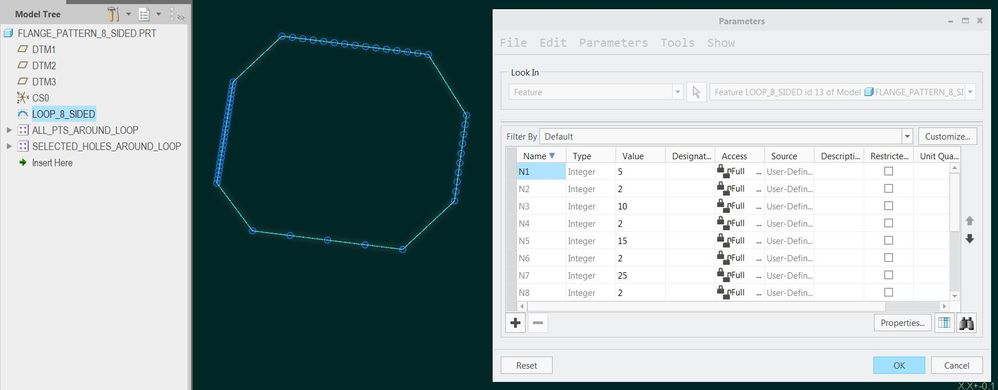

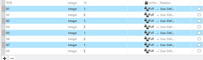

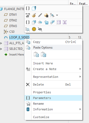

Hi @AlexK , I don't quite understand what you are asking, but with reference to my last post and the model flange_pattern_8_sided.zip,
you can change the "LOOP_8_SIDED" feature parameters "N1" - "N8" to vary the # instances in the 8 segments of this sketch.
For example:
Generates this:
And you are also quite free to modify the shape of the sketch LOOP_8_SIDED
(by dragging the vertices of the polygon - do not delete entities or dimensions or the relations will break), e.g.:
If you are asking how it all works, examine the pattern relations inside "ALL_PTS_AROUND_LOOP" pattern feature and feature relations inside the "LOOP_8_SIDED" sketch.

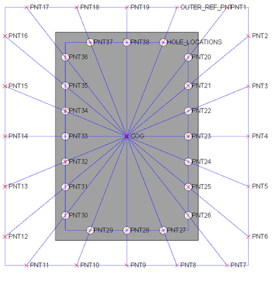

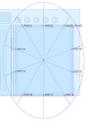

I often use the method using four patterns that @dgschaefer refereed to, but was looking for something to save on all the copygeom features when using top-down modelling. I really like the method @pausob described using relations, but can't figure out how to start the pattern a  away from the corners (other than manually turning off each corner instance)
By using an outer reference sketch, the distribution of holes on each side can be controlled. I've attached an example part, but the images below shows what I mean. I tried the ellipse first, but think the reference rectangle gives more control. It's probably only worth it for top-down modelling.
Sam
Rectangular hole pattern using reference ellipseRectangular hole pattern using reference ellipseRectangular hole pattern using reference rectqangleRectangular hole pattern using reference rectqangle

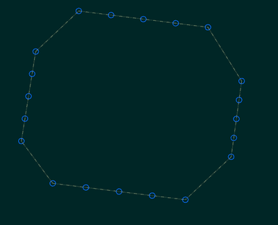

Another option to consider is to extend the 4-sided concept I demo'ed in previous post into an octagonal shape to handle the cases where you don't want the corner points.  more control, so more dimensions to manage...
@pausob ,I tried to do that, but lack your wizardry with Creo relations, so gave up.
Sam
Thank you, but to be honest, I kind of forgot how I did this.  But turns out I had a 16-sided version that I could quickly trim down to be the octagon.  The result is quite generic - each segment can have a different # of instances:
Edith the highlighted sketch to define placement.  Edit the parameters of the sketch feature to drive the # of pattern instances along the edges of the loop.  Edit the relations of the 1st pattern feature (not its pattern relations) to shift the entire hole pattern along the boundary.
Creo4 version file attached.
