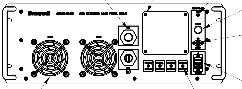

I am using Creo 6.0 and Adobe acrobat Pro DC (64-Bit) for viewing pdf Below is the snap shot of Silkscreen converted from Creo to pdf wherein Silkscreen is overlapping

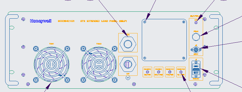

Snap shot of the same from Creo tool:

your problem is related to pentable. You have to set pen widths properly.

Open the PDF in Acrobat or Acrobat reader and use CTRL+5 which should change the line weight on visible lines and may correct the overlap. It may be a quick fix for the issue. The "real" fix is to deal with the pen assignments to avoid this as @MartinHanak has mentioned.

your config.pro must contains following options
use_8_plotter_pens yes
pen_table_file E:\users\creo7_parametric\pentable.pnt
pdf_use_pentable YES
Path used in pen_table_file option is individual for every company.
If you send me your pentable.pnt file I can check its contents for you.
I guess that for your application it is necessary to set small thickness value for pen 1.

Creo does not display drawings on screen as they would be printed.  As @MartinHanak mentioned, the line thickness when printed (PDF is a printed version) is controlled by the pen table.
The PDF view can be improved, in relation to fine details by pressing Ctrl+5.  This is a temporary thinning of all lines to one pixel.
