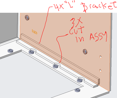

Hello All,
Please see attached.
I have cut 3 "half moons" in my assy which cut thru the "L" bracket. I have 4 "L" brackets in a 4 sided - open front box. When I do this, the system intersects the cut with "3975as9102-4" - which results in the bom as 3 brackets and 1 bracket in the bom instead of 4 of the same. Is there a way to get this back to 4? I had the moons associated to the "L" bracket originally, but broke the association thinking it would fix the problem. Nope. It appears to be associated by the intersection Creo needs to perform. Thereby singling it out as it's own part. If it were done in part mode as a separate item that would make sense. But that is not the case.
The idea here is that we have the same 4 "L" brackets and in the assembly process one will need to be modified with the half moons and weld into place. The remaining 3 will not have the cuts. Otherwise the same bracket. I agree a bit unorthodox, but I am basically modeling up a 2d print again from ACAD to Creo and following the same intent as the original drawing specifies.

Try taking the weight column out of your repeat region. You may still have problems with balloons though.
wfalco16-PearlAuthor
September 29, 2022
We use the weight column
September 29, 2022
With assembly cuts, creo makes "on the fly" or "behind the scenes" family tables with the parts that are affected. If you have the weight column, the weight of the single cut part (instance) is now different than the weight of the generic part. So with the weight shown in the table, creo has to split that qty out to show the weight.
September 29, 2022
if the weight shown in repeat region is 0.08 in both cases, then you can use solution mentioned in https://www.ptc.com/en/support/article/cs278420 document:
Workaround:
  1. Introduce a new part level parameter that extracts the rounded value of  PRO_MP_MASS using Weight=floor(PRO_MP_MASS *100+0.5)/100
  2. Call this new user defined parameter WEIGHT In the repeat region using &asm.mbr.WEIGHT in place of &asm.mbr.PRO_MP_MASS
  3. Access Repeat Region Relations and delete the region local parameter ASM_MBR_PRO_MP_MASS
Maybe you can also use alternative mass properties and set the weight manually to specific value.

Patriot_1776
September 30, 2022
Interesting.  If the weight is a problem, try MANUALLY assigning a weight to the parts (just copy what the mass properties tells you).  This should work because setting a manual weight means the part is not affected by geometry changes.  If you want the weight to change for the parts that have the cuts, you'd probably have to do a family table.
In cases like that I usually make the part a family table part with the instance on it's detail dwg without the cuts being the generic model, and the one with the cuts at the assembly level being the instance.  It should fill out the BOM the same.
Best of luck!
