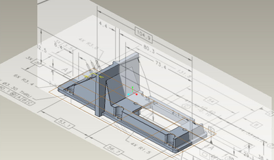

With regard to skeleton modeling strategy, you will need to provide more details what you are attempting to use the skeleton for. To reverse engineer a master model of the molded housings of that calculator, I see no need for using a skeleton.
You can import your photos into a Creo model to use as a reference when sketching. Ideally you will get photos of a top and side view (orthographic projection views) and import them into the top and side planes in a model. You can then use these as a guide to create the sketches needed to capture the form factor in the Creo part.
Details on how to place an image on a plane:
To Insert an Image on a Datum Plane or a Planar Surface (ptc.com)
About images in Creo:
About Images (ptc.com)
This is an example of how images from a drawing were used to create a Creo part with the drawing views imported as a reference.

Are you asking how to create a motion skeleton model? If so, here is a tutorial on how to get started.
Sketch a Motion Skeleton | Tutorial | PTC Learning Connector
