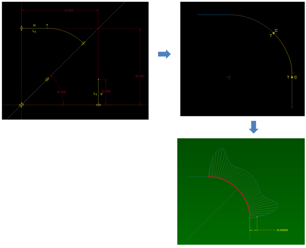

I am using Creo 4.0 and I just want to make a simple curvature continuous round.  I used to have to do this manually without the advanced surfacing package, but I was glad to see curvature continuous constraints built into Creo 4.  However, with those constraints and tangency constraints, this spline shown IS NOT SYMMETRIC.  I tried to constrain the control points and use a control polygon, but none of it yields a symmetric spline!  What is going on?!  I'm downloading Creo 2 now to see if I can get my simple spline back.

Thx, but I need at least one control point in the middle of the spline to approximate a simple round.
This is with a control point at its mid span:
It looks symmterical but actually it is not. I mirrored the cure and it does not overlap exactly to the original one:

wow thanks for doing this.  I used to constrain the control points as much as I could and I assumed it was symmetric.  The newest version of Creo 2 doesn't allow constraints on the control points anymore. what build are you running?

Unfortunately the mirroring of splines has been a problem with proE for a long time.  To do it effectively, I would have to go outside the curve and mirror the spline in a separate curve with a mirror feature, and I wouldn't be able to guarantee curvature continuity across that mirrored feature--only tangency.
After a few weeks trying to do the same things in Solidworks, I have to say that their spline mirroring and spline control features are actually better.  I can actually very easily make this same spline symmetric about that 45 degree centerline.
Hi, I tried this workaround and it may work for you as well. I use a contruction curve(an arc in this case) for curvature reference before mirroring.
The curvature is then mainatin across the mirro plane and symmetrical. I attached the creo2 file for your reference too.

This is a 3-point curve.  It is not bound tangent, rather it is optionally dimensioned to be tangent.
By doing this, it also gives me access to the curvature dimensions.
And I can fix the center vertex orientation by dimension.
The most problematic thing about curves with 3 points is that you have to know that each end is exactly the same length.  Position along the curve is not managed anywhere that I can find.
My results here are Creo 2.  Somehow I am not holding my breath that anything real was done between Creo 2 and Creo 4 on these antiquated curve features.  Just wanted to show you there are some hidden features!
