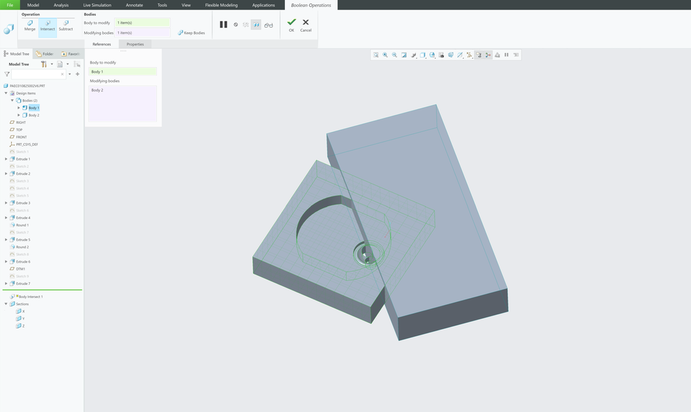

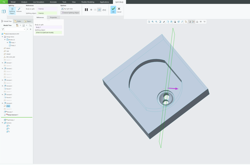

I'm trying to create a mold for my subject and want to split the body using a plane. Which fails.

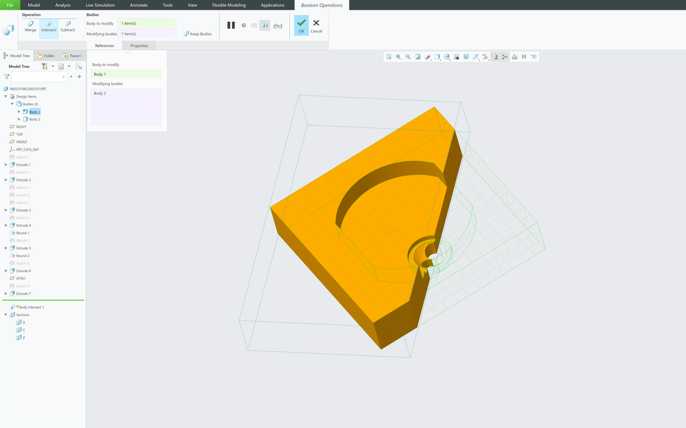

Then I tried to extrude a body out of the plane I want to split, and the use boolean operation feature to either intersect or subtract the bodies. I was successful on one side, but the other side fails, which I believe the same problem it may have faced when splitting using the plane.
Any advise, help is greatly appreciated. Thank you! Fails trying to split using a planeFails trying to split using a planeOne side successful using another body to get the intersectOne side successful using another body to get the intersectOther side fails trying to do the same operation.Other side fails trying to do the same operation.

Change the accuracy of the part from 0.01 mm to 0.001 mm, regenerate the model and then create the split feature, it should work.

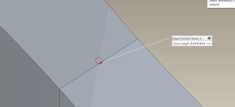

The issue was created by round 2, it creates a geometry artifact that results in a small edge when the split body feature is applied. That spherical well should be created to avoid this unless your design intent was to create that small flat between the holes.

Thank you for the explanation. I managed to split it after changing the accuracy.
