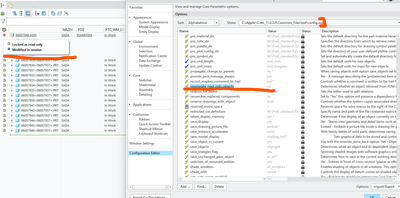

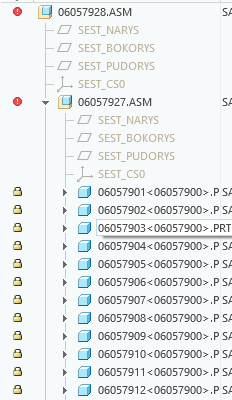

ilyachaban
Windchill smartlock and regeneration in Creo
Why objects which is regenerated in creo changes it's state from
to
after regeneration.
Object is read only why has it been chagned during regeneration?

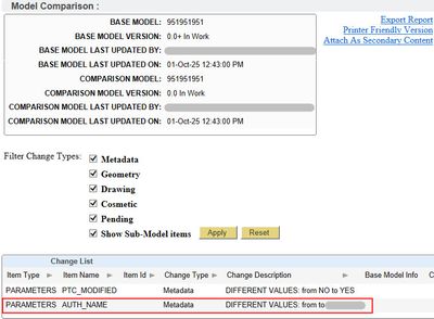

Open and regenerate the assembly
Execute the Tools > Compare Assembly command
Select the same assembly from the workspace.
Creo will show you what has changed after regeneration, and you will be able to locate the problem
In my example, the AUTH_NAME parameter gets its value from PTC_WM_MODIFIED_BY through an equation

Set regenerate_read_only_objects to NO in your config.pro
We can’t change this. The parameter is set to YES because it comes directly from the drawing.
We use parameter in relations whici part_number = REL_MODEL_NAME
This parameter is hown on drawing. And if this parameter id used by instance of family table. then after regeneration each instance get's number of generic. Total disaster happens then when manufacturers get's our drawings with generic numbers in it.
According to your recommendation on test data i've tried to change this parameter ot NO and still same issue.

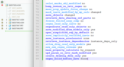

What version of Creo are you using?
Are you using Windchill with your data?
Are these family tables saved in the current version of Creo?
Try this hidden config.pro option.
Article - CS170675 - Definition and values of hidden config option regen_read_only_insts in Creo Parametric 2.0
Creo verson 11.0.3.0
Windchill version 13.0.2.4
all objects has been created in new creo and checked into new windchill. Everything is stored and created in versions where it's used
Hidden config option didn't help. All three values does change top level assembly. Each time red symbol appears after regeneration. On retrieval there is no errors/warnings

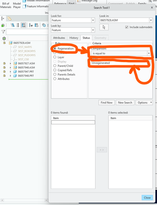

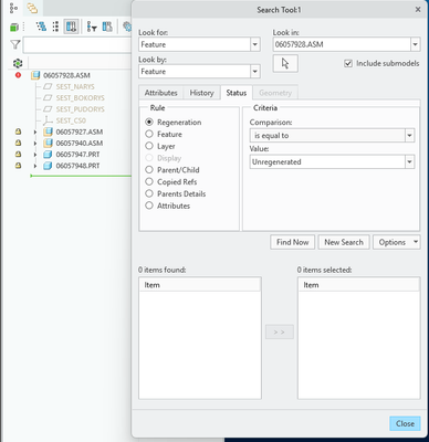

Thank you so much. Have never used this tools. Now it's diverged from one big problem to many small problems. Which we will solve along the way.
For now after researching different model there is alot of geometry issues and alot of parameter issues. So now we can start working on it. Also there is parameter which helped to reduce amount of correct models which is: regen_simp_retrieve NO
So whole problem is pinpointed and work finally began
