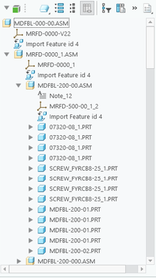

Hi. I've got an important question for me that i have trouble solving myself and couldn't find answer online. I am making a project with my friend and he send me a step file and my question is if am i able to create balloons in drawings and how??? Also if can i fill table fast?

unfortunately, the description of the problem is insufficient. Please publish following:
  • picture of assembly model tree
  • picture of repeat region showing repeat region parameters

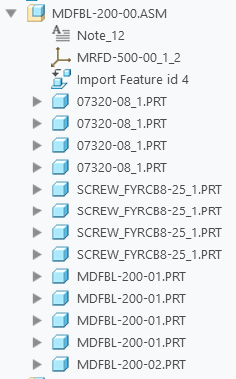

well... you can say it worked but i can now i can see every single part of subassemblies
again the same meaningless description.
Please publish picture of repeat region and explain what is wrong.
Martin Hanák
i want to have for example just mdfbl-200-00 listed not every single item
if you want to show parts included in mdfbl-200-00 assembly then create drawing containing mdfbl-200-00 assembly, only and use Flat repeat region.

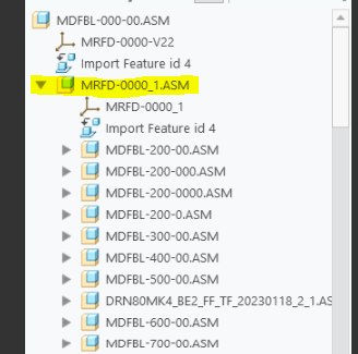

Dale_Rosema
(To:BL_10341087)
When you mention "parts from the assembly" are you referring to subassemblies to the assembly, or subcomponents to the subassemblies? (i.e. children or grandchildren?)
subassemblies
Dale_Rosema
(To:BL_10341087)
From what I can see, you only have one part in the top level assembly:
how can i change that?
BR84
(To:BL_10341087)
You have got two options:
  • create drawings of sub-assemblies (self-explanatory - one sub-component -> one drawing, until you reach part level)
or
There are pros and cons to both of these ways of operation, so you have to decide.
