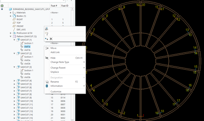

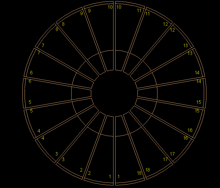

I have a UDF which creates cuts and automatically numbers the cuts around a circular part.  The numbers are in the correct place, but I want them to be rotated so they are readable from the center.  Is there a way to do this? udf.PNG

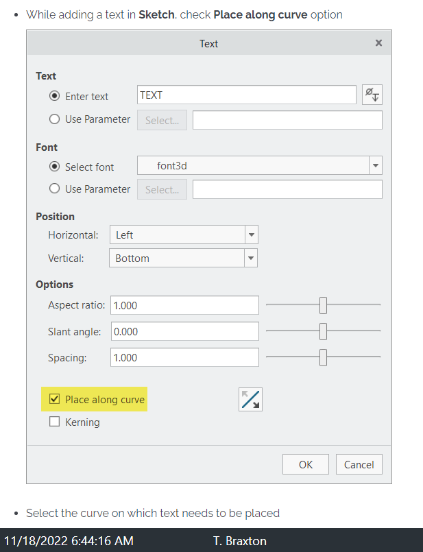

Start here:
https://www.ptc.com/en/support/article/CS254748
This is a practical example with model to query. It is linear but the approach will be the same.
https://community.ptc.com/t5/3D-Part-Assembly-Design/text-repetition/m-p/697310

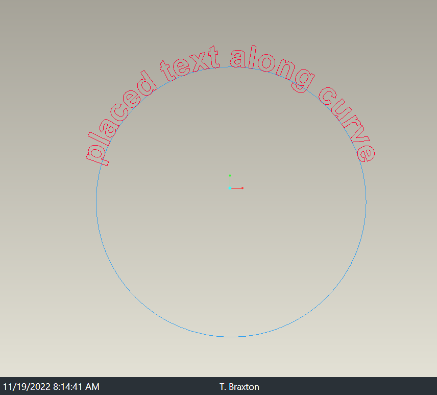

If I understand your design intent, then you can place the text along a circle. Create the circle to locate the text first and then use it to locate & orient the text.

This will orient the text as you intend.

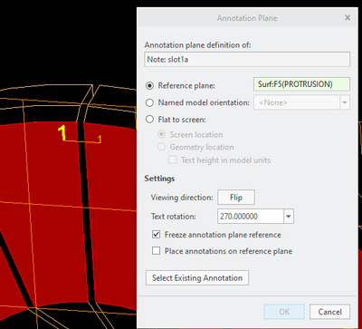

Thank you all for your responses.  My numbers are not text in a sketch, they are notes.  It is part of a pattern, as the quantity needs to be adjustable.  Each note is placed at the end of a short curve that is in the first instance of the pattern.
I can unplace the note and replace it with orientation, but there is no way to automatically rotate it.

I didn't even know one could pattern notes like this, and automatically assign the notes proper names.
DCG
(To:pausob)
This UDF was created a long time ago, and not by me.  The notes are not automatic, each one has the number typed in (it goes up to only 18).  Somehow when the quantity is changed to less than 18, nothing fails.

Start here:

Your text appears to be constrained vertical.  I would suggest making it parallel to the cut edges.
