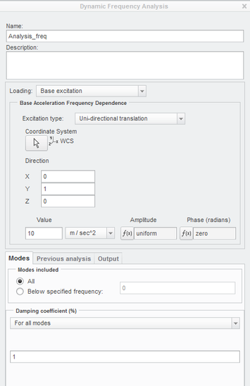

At the moment, I have a simple dynamic freq.analysis, the settings is default:

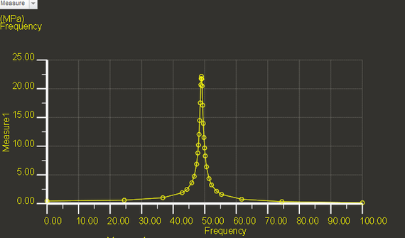

I have a monitor point which shows the stress value in the function of frequency:
It can be seen that tha max stress is at the eigen freqency (~49Hz). But what does it mean this diagram for me? You tell me that it is not enough to evaluate lifetime. But what is the information which is useful for me from this result/diagram?
Roland
skunks
(To:rrakos)
info
regards
paul
