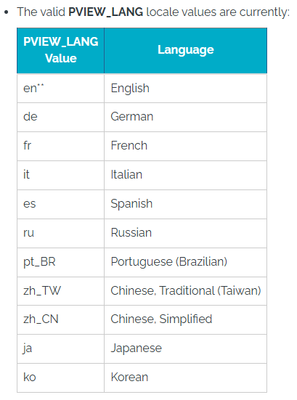

how did you set PVIEW_LANG=en ?
Martin Hanák
On https://support.ptc.com/help/creo/view/r9.0/en/index.html#page/creo_view/install_config_guide/Starting_Creo_View_and_Modifying_an_Installation.html I found this ... try setting PRO_LANG=english, too,
Setting the Language
By default, the language of the Creo View user interface is determined according to your operating system’s settings. To set a different language for Creo View from the operating system language, use the environment variables described below.
The generic environment variable, LANG, sets one language for all programs on your machine. You can use PTC-specific variables to designate another language for one or more programs:
PVIEW_LANGCreo View
PRO_LANG—Creo Parametric and its associated applications. When you set this variable, you must also set PVIEW_LANG. This is true even if you want the same value for PRO_LANG and PVIEW_LANG.

i found my mistake, i was adding the variable in the user variable instead of the system variables.
Hello, can you help me? Im having the same problem that you did, how do you ended up solving it?
I guess @JAntunes set environment variable PVIEW_LANG on system level and assign it value en.
https://www.ptc.com/en/support/article/CS96862
