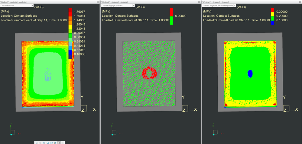

This works for me in CREO8.
Maybe the issue is one of load timing.
First the preload needs to be applied, then when the preload is at its full value, the 0.1N sliding load is applied.
When I use the default "Time Dependence" of RAMP the analysis will not successfully run.
Here is a more correct time dependence.
Preload (1MPa)                  Pull  (0.1N)
Time    Value                      Time   Value
0          0                             0         0
0.5       1                             0.5      0
1          1                             1         1
Results Creo7Results Creo7
I also ran with the pull at 500N instead of 0.1N.  Although there was some movement, complete sliding was reported at 400N but not at 300N. (the analysis of course failed at 400N because it just displaces to infinity.)
hopefully this helps.

First of all, Thanks a lot @SweetPeasHub for this demonstration! Let me jump into this thread to share some further views.
Finite Friction Support was enabled starting from Creo Parametric 3.0, and documlented in Defining Contact Interfaces with Finite Friction section of What's New chapter of Creo Parametric 3.0 (with a nice movie with sound illustrating the capability).
=> Direct URL below, which will be for sure very usefull to get a good understabnding:
Defining Contact Faces with Finite Friction - YouTube
Related to this, please consider what follows:
  • Usage of Finite Friction is available ONLY when Large Deformations are enabled in Analysis Definition
(confirmed in the Description field of the What's New above section, in the movie, and also in article 349763).
  • And configuration of Large Deformation analysis requires indeed access to Advanced Pro/Mechanica Structure
(This is officially documented in article 42018)
This probably explain why you're facing those challenges when trying to use the "Finite Friction" functionality, if you confirm you have no access to Advanced Creo Simulate license. Without this license, I'm afraid to not be in good conditions to provide further guidance in this direction.
Serge
That contact_test is tricky. It really needs dynamic analysis, but here is the fix.
smaller elements (10mm works)
Add gravity load 1.0 grav -Y and 0.1 grav Z.
Move the block -3.1mm X so interface4 can initiate contact.
The force at interface4 will be correctly reduced by the friction loss. (about 9N)
-regards
I forgot something. Add a small clearance on the -Z side to interface2.
