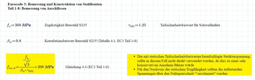

I want to try to extrapolate force (tension) from a welded structure to perform a calculus as prescribed by EN1993-1-8.
I want obtained the forces by measures of a simple truss loaded by transversally.
On each side of the green beam I want to simulate the presence of two filled weld with a=5mm.
I used two kind of measure: Force and Interface.
Looking on the Help it seems the proper one should be the force measure, but, in this case, I think both should be right.
Exept that the results are different, so which are the right?

I think EC3-1-8 is not possible for FEA

I've translated from German your post regarding to the ability to use FEM's datas for EC calcs.
If I've well understood (...) your focus is not over the stress results taken from the measures, but it's about the use of coefficients imposed by the EC (that presume raws calcs of stress) togheter with precise stress results. All of this brings to be excessively conservative.

No no,
EC3-1-8 is NOT for structural stress approach (FEA)!

The EC3's theory establishes the use of a "spreaded tension" all over the section of the weld.
This tension will be reworked through a serie of coefficients to take back the calculated stress to "the real one".
The coefficients that permit all of this are obtained by tests over welded samples, with a certain shape and material (especially construction material like S235). One must always try to trace it back to welded joints like these to maintain valid the calculations.
FEM permits to obtain tension punctuals evaluations over whatever welded links geometrie.; trace we back to the model of a normalized tension over the entire section means loosing much of FEM's potentialities.
However, I believe that, if one want really following the EC norm, the method of the normalized/"speaded" tension evaluation is applicable (through those measures which I've asked in the firstes posts of this thread).
