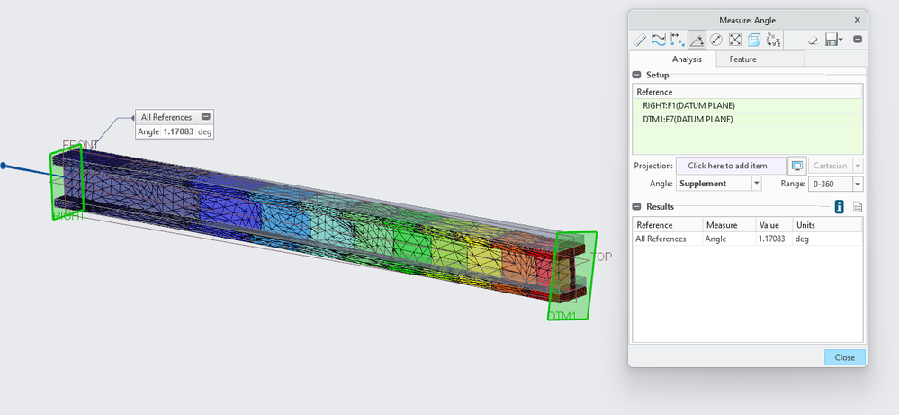

I'm not sure if there is a direct way to meet your needs. Allow me to suggest a process using Creo Simulate:
  1. Run simulation
  2. In the deformation simulation view (without scaling), export the result to VRML file type.
  3. Import the VRML file into your model (Facet).
When you have the two, you can perform relative measurements on them.
