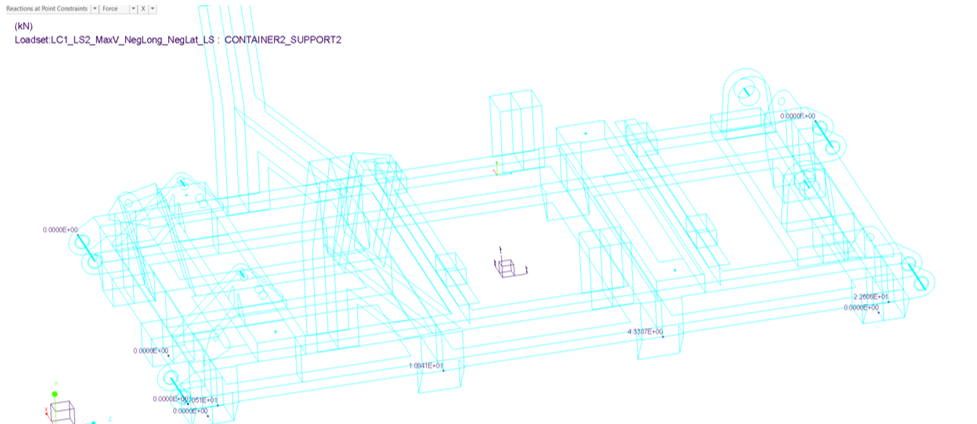

Whenever I print to pdf, the point constraints result plot lose part of its resolution, making them close to unreadable. Is there a way to increase the font size of those particular fonts bigger?

I don't know how to change the font size,
but I always use measured values on springs to ground for bearing reactions.

my workaround in creo simulate 2: screenshot

Thanks for your anwser skunks.
I am using Creo 10. I have swapped one of the point constraints for one "spring to ground". How do you manage to now see that spring force / ground reaction in the result window? Only way I can find that value is by using a measurement.
