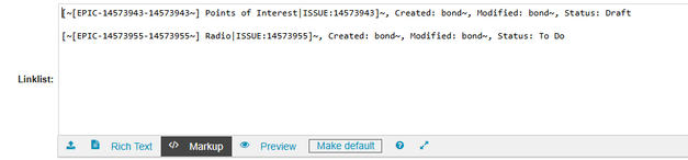

not exactly. In Editor mode:
, and in markup:
Thank you in advance! 👍

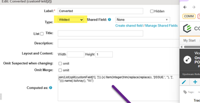

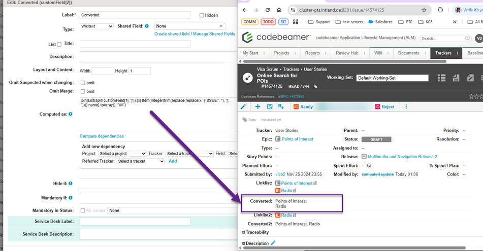

EvaBertalan
(To:vjub58)
Hi @vjub58 ,
I've built the formula. I'm not sure it will work in all cases, so it might need tailoring later.
join(List(split(customField[1], ']')).{x| Item(Integer(trim(replace(replace(x, '[ISSUE:', ''), ']', '')))).name}.toArray(), "\\\\")
where customField[1] is the wikifield containing the links.

Just for the case I repeat my question: is the new "computed field" "Converted" of the type "wikitext"?
Thank you and see you later! 👍
EvaBertalan
(To:vjub58)
Hi @vjub58 ,
Yes, it is wikitext:
