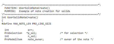

FV
(To:CHASEONHO)
UgSolidNoteCreate.c in examples...
