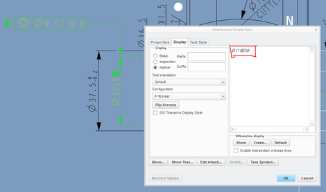

We want to get the drawing display dimension value, as shown in below snap.
So please can i know how we can get this values.

Can you explain what you are aiming?
I am not able to understand your query...

extern ProError ProDrawingDimensionVisit(
   ProDrawing               drawing,
   ProType                  type,
   ProDimensionVisitAction  action,
   ProDimensionFilterAction filter,
   ProAppData               data );
    Purpose:
Visits all dimensions stored in the specified drawing,
i.e. all dimensions whose default names start with
"dd", "rdd" or "add", therefore all dimensions created in
the drawing when the config.pro option "create_drawing_dims_only"
was set to YES.
    Input Arguments:
drawing -  Handle of the drawing whose dimensions are to
  be visited.
type -  PRO_DIMENSION or PRO_REF_DIMENSION
action -  the function that gets called for each drawing
  dimension being visited.
filter -  the function that gets called for each drawing
  dimension. This function decides whether the
  dimension should be visited or skipped. If NULL,
                           all dimensions are visited using the action function.
data -  caller-specified data that gets passed to the
  action and filter functions.
    Output Arguments:
None

Thanks.
