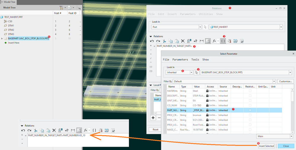

pausob
(To:AnthonyC)
Well, when writing the relation, you can follow this process to "look in" the inherited model for the parameter to pull:
The feature ID that identifies inheritance will be "automatically" written into the relation...
