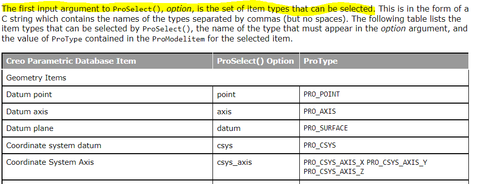

the first argument to ProSelect() function is a 'run-time' selection filter.

I think I was not specific enough. I intended to say without using function ProSelection.
Now I think that the filter in the lower right of the status bar does not anything but just serves as parameter to be applied for the above function.
