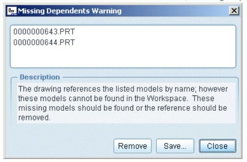

I need to remove all unused drawing models.
And I don't know if this is possible to do it with a macro or something like that.
can help me somebody?
Thank you,
Alberto Todisco

Hi Alberto
If you don't use Modelcheck, but you are working with Windchill, you could use this creo config option:
cleanup_drawing_dependencies=yes_cs_not_required
More info in this Article
Hi Trebla,
that's the better solution!! thank you so much

You have to add inside your config.pro:
cleanup_drawing_dependencies yes_cs_not_required

I don't think that is going to do what you want.  All the does is remove the reference.  Not the actual model.
Trebla
(To:STEVEG)
Yes Steve, it works. More info in this Article
STEVEG
(To:Trebla)
Did you test it?  I don't think it removes that actual model from the drawing.  I believe it removes only the REFERENCE link to a model.
Trebla
(To:STEVEG)
Hi Steve, yes I tested, It removes all 'unused drawing models' not the actual model.
To remove the 'unused drawing models' is what Alberto_Todisco was asking for.
Yes, you only erase the missing dependents references, but that was the aim.
