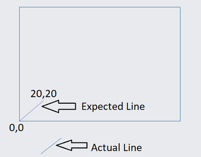

When drawing a simple line using the sample VB API code, a line appears in the drawing but the wrong place consistently.
Using the code below, a line is expected from 0,0 to 20,0

When I check the coordinates again, they show correct values.
MessageBox.Show("Start = " & start.Item(0).ToString & " x " & start.Item(1).ToString & vbCrLf &
"End = " & finish.Item(0).ToString & " x " & finish.Item(1).ToString
Am I missing any transformation?

From the documentation:
The VB API methods and properties that manipulate drawings generally use screen coordinates.
You need to transform drawing coordinates to screen coordinates before to put it into a method.

Thanks @RandyJones
I was using VB API as mentioned in the original post.
For that, I found a more relatable post here:
The required lines are:
Dim currSheet As Integer = creoDrawing.CurrentSheetNumber
Dim sheetTransform As IpfcTransform3D = creoDrawing.GetSheetTransform(currSheet)
sheetTransform.Invert()
Dim startPtSheet As IpfcPoint3D = sheetTransform.TransformPoint(startPt)
Dim endPtSheet As IpfcPoint3D = sheetTransform.TransformPoint(endPt)
