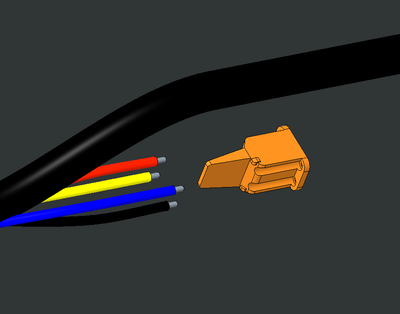

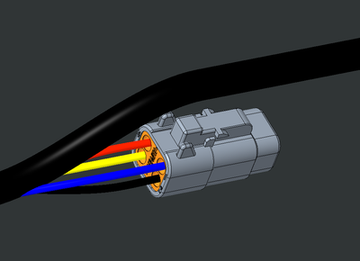

My company is wanting to start modeling wiring harnesses in 3D. My plan was to add the connectors into the CAD model with an axis at each point where a pin would be.
My current problem is I don't know what to do about the terminals and the locking mechanisms for the terminals (like the small plastic piece you shove in a Deutsch connector so the pins don't come out). I would really rather not add the terminals and locks into CAD just because there just such tiny pieces.
We have part numbers for each lock and terminal, would it be possible to somehow add that information to the connectors Creo file? So once the 2D drawing is made is can pull in and show the connector the terminal and the lock when you make one of those tables?

There are a few options.
We just have simple 1mm diameter, 1mm long cylinders that have the correct part number for parts we don't care about displaying accurately like pins/wedgelocks.  We assemble them to the CSYS of the connector, so they are hidden inside of it, but they show up on BOMs.
You can also setup your connectors in subassemblies that have the hardware already assembled in.  We do this with many of our connectors.

The other guy seems like he has a better suggestion?  Unfortunately there are not really any good standard practices from what I see when it comes to Creo Cabling, so we are going to have to look into the assembly, include option.
At the moment what we do is we have a harness assembly.  Under it is the various pin parts, connector subassemblies, and the harness.prt.  Within the connector subassemblies is the wedgelocks, labels, etc. that always go with those specific connectors.  It's definately a bit tedious, but it's what we've found works the best for our harness vendors and quality control.

My advice, DO NOT use the technique where you put lots of fake parts into the model just to massage the BOM. If you're going to do that, please for the love of all that's good, look into using included items. (Assemble-->Include).
What I'm saying is... there's already a way to add small things to the BOM without constraining them, without making 20,000 BULK items, and without making little "magic cylinders" to handle every item. It works like a champ and has several benefits over bulk items. Eventually I hope to convince PTC to abandon it's misguided attempt to use bulk items to solve these problems (coming in Creo 12).
Also... if you're trying to route harnesses in 3D in Creo, you don't want axes in your connectors - you want one or more entry ports which are coordinate systems with the positive Z axis facing down the wire (away from the rear of the connector).

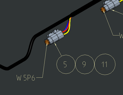

We only use physical pins because of our windchill BOM requirements, and the requirement we have balloons on our drawings.

Thanks for the feedback on my suggestion.  I've never used the assembly include option before.  Does it work with BOM Balloons, or is there a way to make it work with BOM Balloons?
It does work with BOM Balloons.
For any item which was included, you can select BOM Balloon-->By Record (drop-down menu under the main BOM Balloon icon). Next, you'll select an included item from the BOM. Finally, you can select to make a balloon unattached to anything at all (you can then merge it to a stack of other balloons if you wish) or you can create a balloon with a leader line and point to anything you want (no restrictions).
