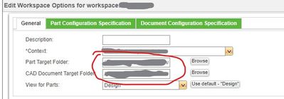

We use Windchill and Creo 9 (will soon be upgrading to Creo 10. We also use Windchill for document management.
In Windchill, each product has three main folders CAD, Promotion requests and Documents.
When creating a Workspace the Context is set to the product root in Windchill and so is the Part Target Foler and CAD Document Target Folder. I know that I can manually go in and change the Part and CAD document target folder to the Windchill CAD folder. However, is there a way to, in the config.pro for example, to set the CAD folder by default, so that all are not directed to the root by default? Also that it will use the current context, since the context will change depending on the product/workspace.
