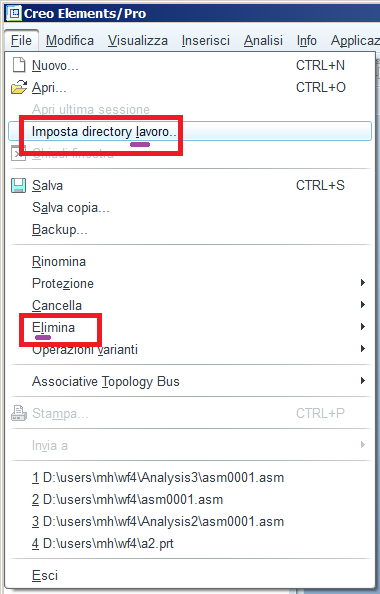

Hi
so,  for WF5  the third line (the shortcut) of the select_working_directory.txt should be 'wl'  (see attached image)
But I noticed that, while in Creo4 after pressing ALT+f+m+w , the dialog window open automatically, on WF5, after ALT+f+l the dialog window is not open but is like in the picture attached. It opens only after pressing ENTER.
Marco
@mdenicola wrote:
Hi

@mdenicola wrote:
sorry.. here it is
Maybe final question. Does the tool work in  Italian version of Creo Elements/Pro 5.0 ?

I tested the tool with Creo Elements/Pro 5.0 M280 (ITALIAN).
The tool does not work because there are two commands using underlined character l (in File menu) - see picture.
Solution ... put following 3 lines into select_working_dir_config.txt file.
(attivo)
Creo Elements/Pro
fl{ENTER}
Martin Hanák
