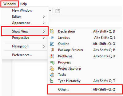

I am not able to build this project at the build step of this tutorial.
Im having gradle installed on system and also installed gradle buildship in my eclipse but still not getting option to build with gradle as shown in above images for this tutorial.
I need help on this issue to finish and conclude this tutorial.

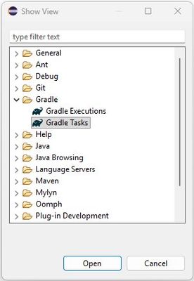

Feb 3, 2026 9:04 AM UTC
Replying to MB_10808246
If you don't have the Gradle (STS) when you right click on the project, you can go to "Window->Show View->Other..."
Then on the popup you go on "Gradle-> Gradle Tasks" and click open.
On the bottom panel there should be a "Gradle Tasks" menu that pops up.
On this menu you go to "MyThingworxWeatherExtension->Build->Run Gradle Tasks" and it should be good.
