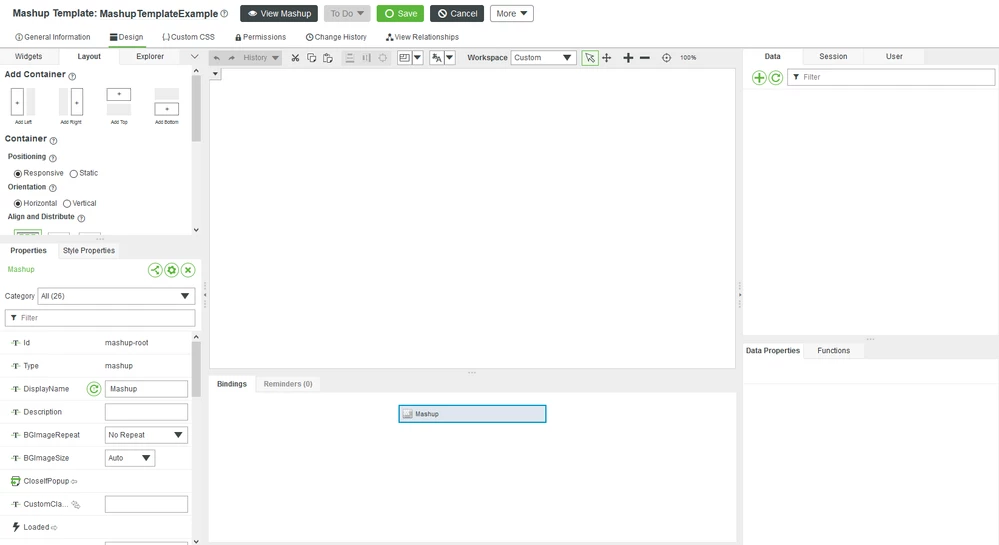

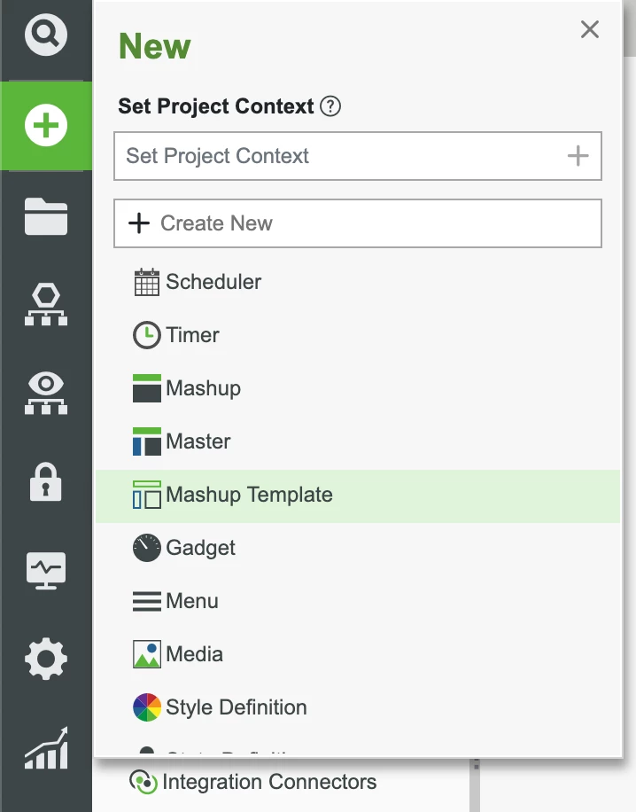

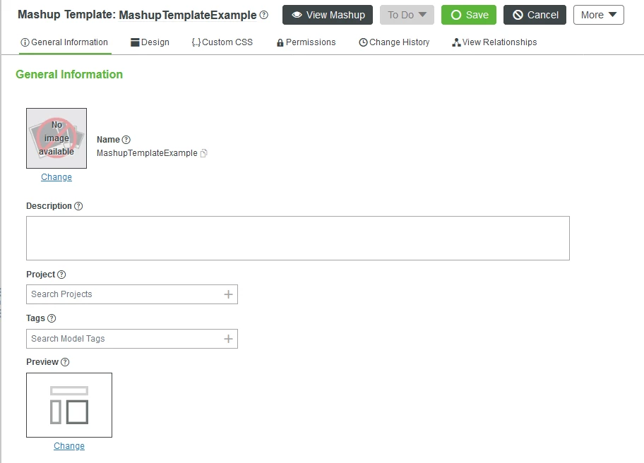

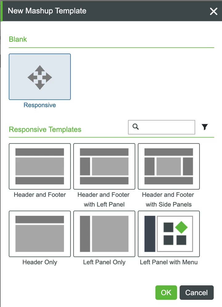

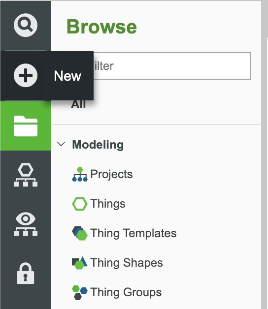

  1. In the ThingWorx Composer, click the + New at the top of the screen.
  2. Select Mashup Template in the dropdown.
  3. Select Responsive for the layout option.
  4. Click Ok.
  5. Enter a name for the Mashup Template, such as MashupTemplateExample.
  6. Set the Project field (ie, PTCDefaultProject).
  7. Click Save then click Design to get to the Mashup canvas.
You've now created a Mashup template that can be utilized to create other Mashups faster and easier. After saving, you will have the regular Mashup design window as shown below.

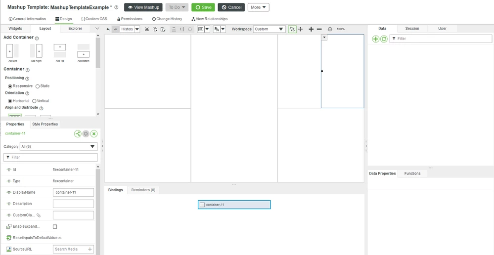

Let's add some containers to our UI. This will allow for easier grouping of UI components or to allow users an easy comparison of charts and graphs.
  1. Select the Main layout and click Add Left. Do this a second time.
  2. Select the left most container and select Add Bottom.
  3. Select the right most container and select Add Top.
  4. Select the top section that was just added and click Add Right.
You should have something like the image above. Now that you have formulated these sections, you can use the standard methods to add Widgets, styles, and data. In the Nested Container section, you can decide on how these containers should be sized as your add new sections to your page.
If you make any changes to this Mashup Template, you are then able to create new Mashups based off of this Mashup after select Responsive as the layout option. We will be making some of these changes in the next steps.

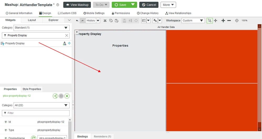

  1. Open the AirHandlerTemplate Mashup, which contains the layout that will be used in this example.

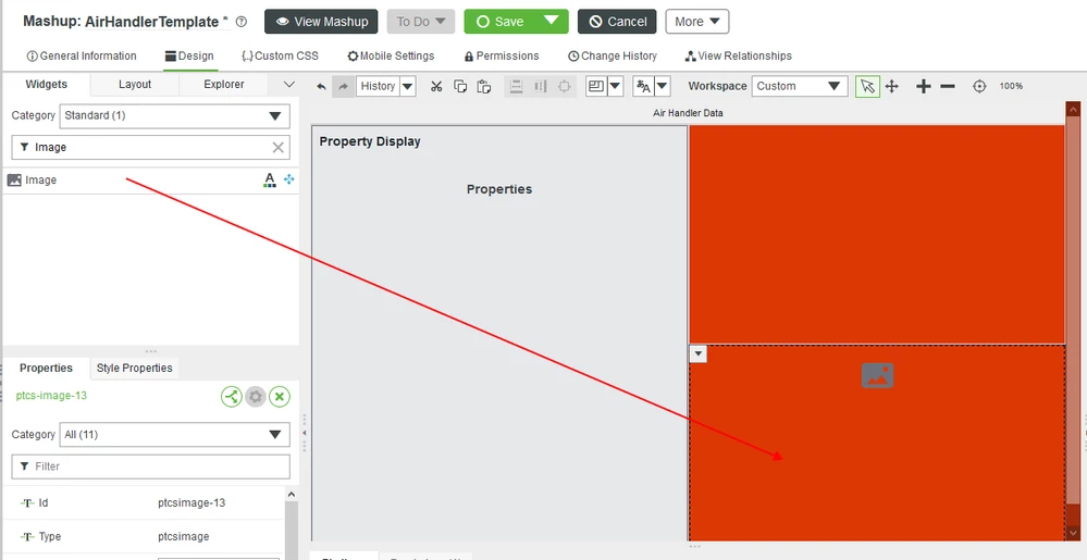

  2. Drag and drop a Property Display Widget onto the left column in the layout on the canvas.

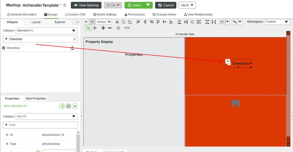

  3. Drag and drop an Image Widget onto the bottom right space of the canvas.
  4. Drag and drop a Checkbox Widget onto the top part space of the of the canvas.

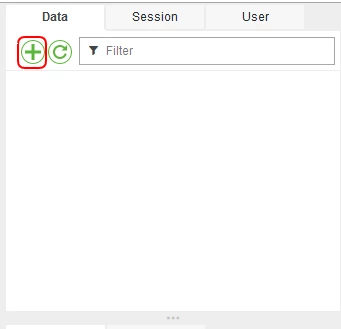

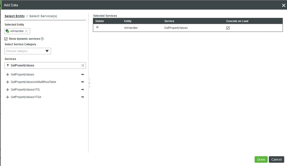

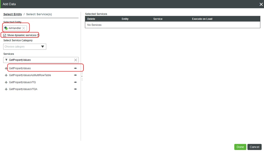

  5. Click the + button in the Data panel.
  6. Check the Dynamic checkbox.
  7. Select the AirHandler in the Select Entity text box.
  8. Filter for and find the GetPropertyValues service, then click the arrow.
  9. Check the Execute on Load checkbox.
  10. Click Done.

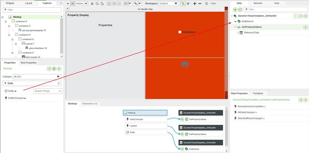

Step 4: Define Entity Parameter

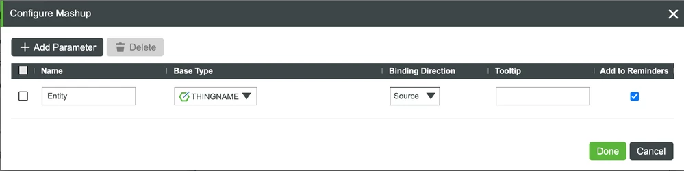

Mashups come with a parameter named Entity. This parameter is a BaseType of ThingName and often used in dynamic Mashups as an input to Services or outlets of information. In our example, the Entity parameter is used to tell the Mashup which implementation of the AirHandler we should present.
With the updated AirHandlerTemplate Mashup still open, follow the directions below:

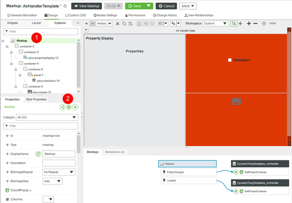

  1. Select the Mashup in the Explorer pane.
  2. Select the Settings icon in the Widget properties panel.
  3. The Configure Mashup Parameters pop-up will appead. Add a parameter named Entity with a Base Type of Thing Name. Select Done.

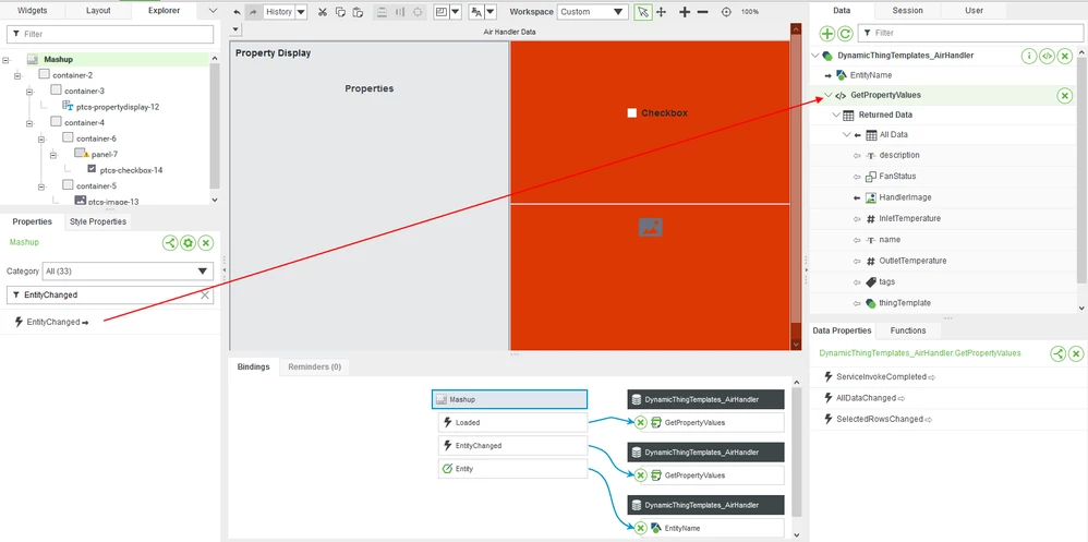

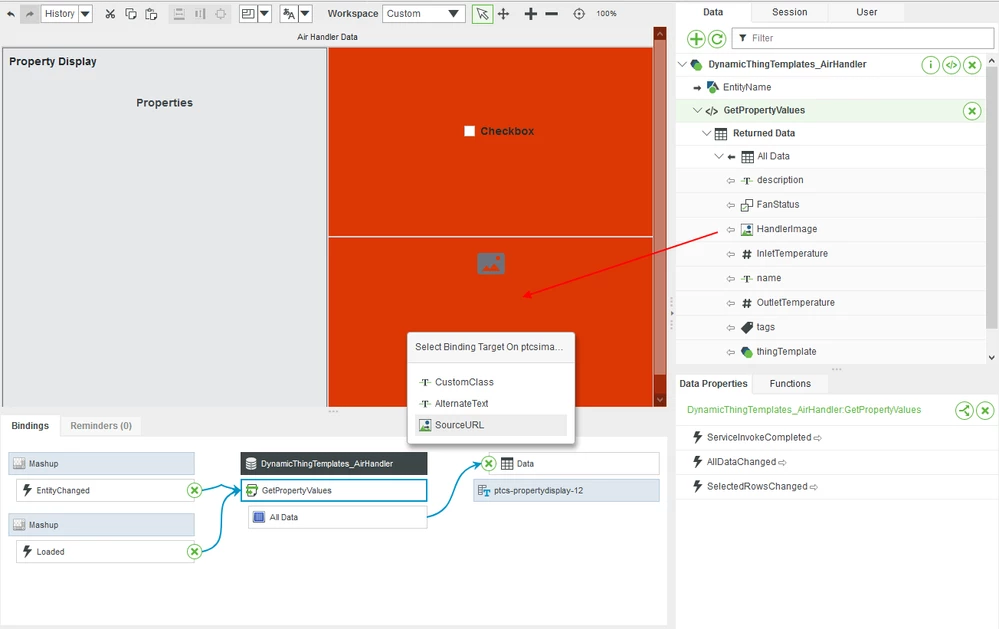

  4. In the Mashup Property panel, drag the Entity parameter to the EntityName field of the DynamicThingTemplates_AirHandler data source.

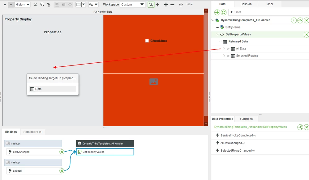

  5. Select All Data from the GetPropertyValues Service and drag it to the Property Display Widget. When prompted, select Data from the Select Binding Target pop-up.
  6. Expand the All Data section of the GetPropertyValues service. Drag the FanStatus field to the Checkbox Widget. When prompted, select State from the Select Binding Target pop-up.
  7. Drag the HandlerImage field from AllData section to the Image Widget. When prompted, select SourceURL.
  8. With the Mashup selected in the Workspace pane. Drag the EntityChanged event from the Widget Properties panel to drop GetPropertyValues service. This ensures that the GetPropertyValues service will be called at runtime when the Mashup shows a new Entity.

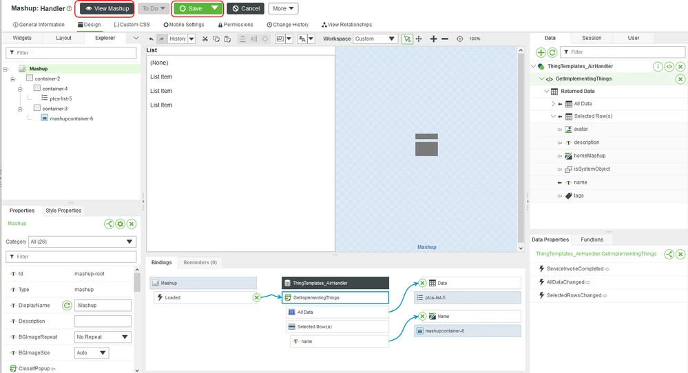

  1. Create a new Mashup named Handler and add a column.

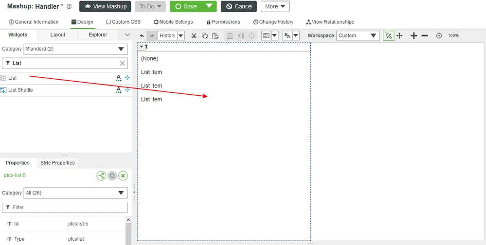

  2. Drag and drop a List Widget onto the left column of the Mashup layout.

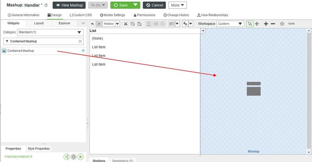

  3. Drag and drop a Contained Mashup Widget onto the right column of the Mashup layout.
  4. In the Name property for the Contained Mashup Widget, filter and select the AirHandlerTemplate Mashup.

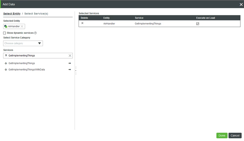

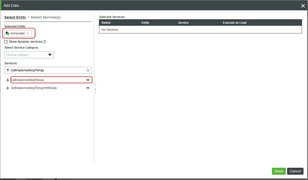

  5. Click the + button in the Data pane.
  6. Select AirHandler in the Select Entity search box.
  7. Filter for and find the GetImplementingThings service, then click the blue arrow.
  8. Check the Execute on Load checkbox.
  9. Click Done.

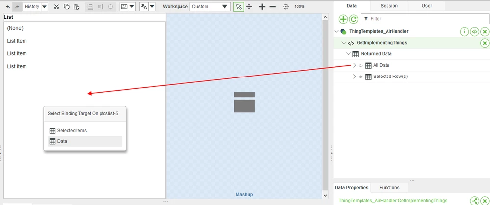

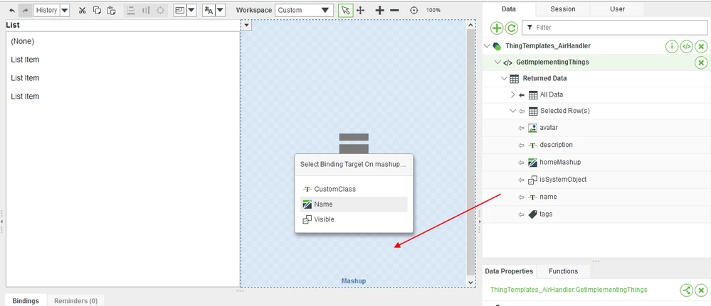

Configuring Data Input
  1. Select All Data from the GetImplementingThings service and drag it to the List Widget. When prompted, select Data.
  2. Expand the Selected Row(s) section of the GetImplementingThings service. Drag the name field to the Contained Mashup Widget. When prompted, select Name.

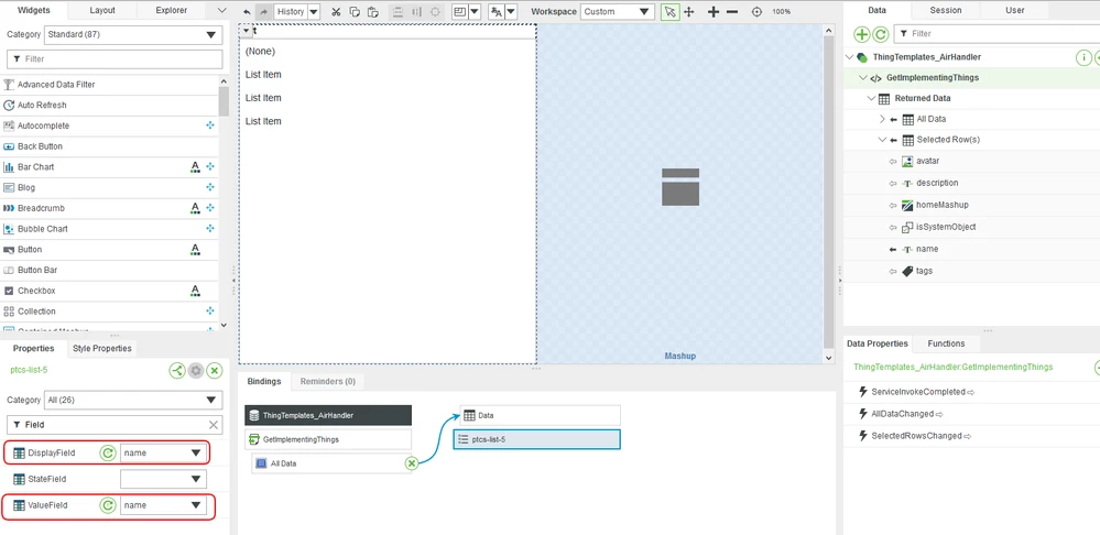

  3. Select the List Widget in the Workspace pane. In the Properties section, set the DisplayField and ValueField properties to name.
  4. With the List Widget still selected, check the AutoSelectFirstRow property.
  5. Click Save, then View Mashup.
You will see Fans and Heaters in the list because they are both implementations for the AirHandler template. The Mashup can be used for both scenarios and will show the property fields for both. The AirHandlerTemplate can be used with other templates because it is only a Mashup Template.
