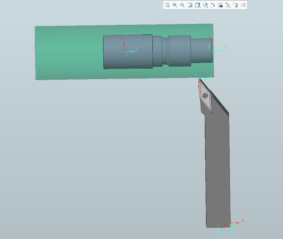

Hi, how do you define the tool for the lathe.
I didn't get it from the instructions
I tried to create a Solid tool and I added CSYS TIP and CREO doesn't want to create paths even though I increased BACK_CLEAR_ANGLE.
Could someone send me an example of how you define this?
Thanks in advance

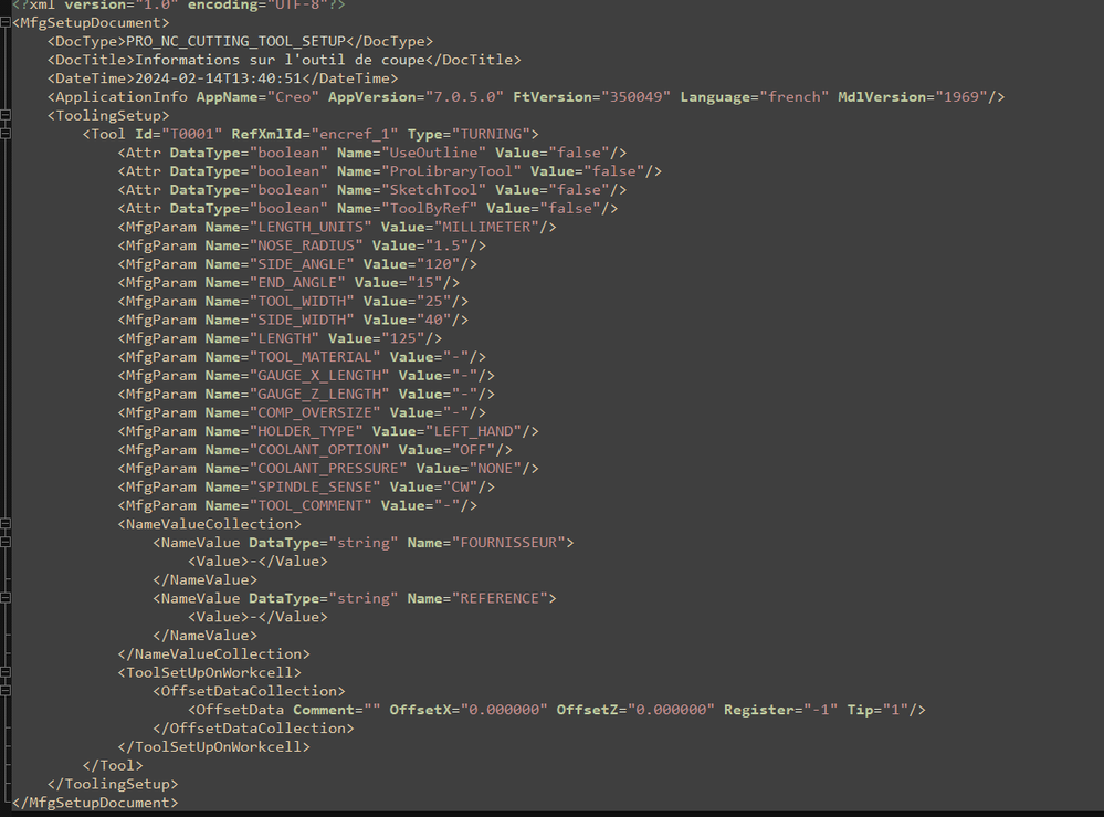

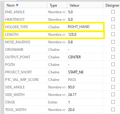

I udpate the tool t3_hrub_r0_8.
Modify tool parameter name TOOL_LENGHT by LENGTH
Modify tool parameter HOLDER_TYPE value by RIGHT_HAND

If I understand correctly it is always necessary to model the tool and the plate, because when I tried to import the step and define the parameters it only displayed the tool, but not the pathknife.png
or am I making a mistake somewhere?

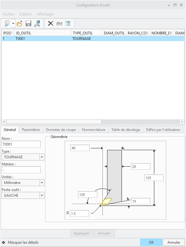

I also defined these parameters in the solid model tool.
Maybe I misunderstood how to measure the values on the tool to be filled into the creo.

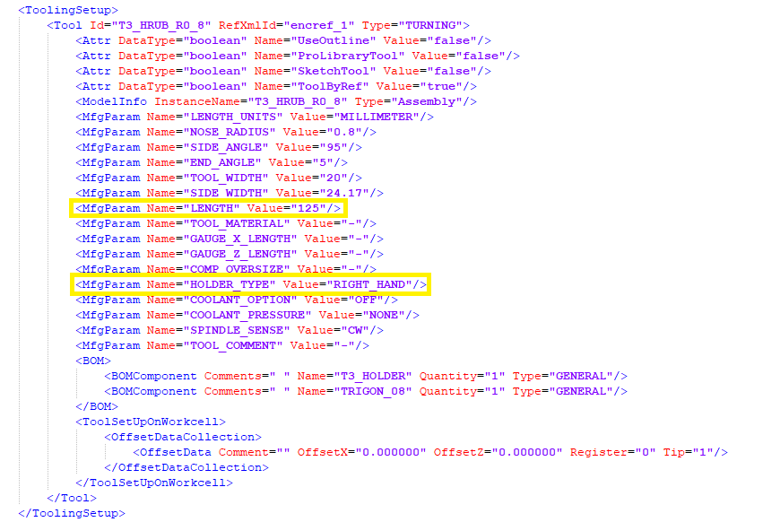

Thank you so much!!

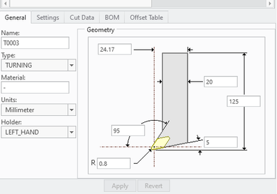

When I want to insert a tool using "Use Outline" the path is not generated, but when I insert a tool using "By Reference or By Copy" the path is generated. So is it correct to use " By Reference or By Copy"?
I am just starting to use turning in creo.
How do you define the tools?
Do you always create models or do you use Creo default tool modify?
I don't understand creo tool modify, I don't know how to define "tool" for example Trigon by this.

I always use solid tools. In most cases I use 'By Reference'.
Look in CREO help, links below to see differences between modes.
https://support.ptc.com/help/creo/creo_pma/r9.0/usascii/#page/manufacturing/nc/to_use_a_tool_model.html#
https://support.ptc.com/help/creo/creo_pma/r9.0/usascii/#page/manufacturing/nc/to_use_tool_outline_in_turning.html#
https://support.ptc.com/help/creo/creo_pma/r9.0/usascii/#page/manufacturing/nc/example_using_the_tool_outline_in_turning.html#wwID0ECLVQ
If you want to understand 'CREO TOOL MODIFY', save a default tool and open the tool  XML file (path according to configuration option pro_mf_tprm_dir).
