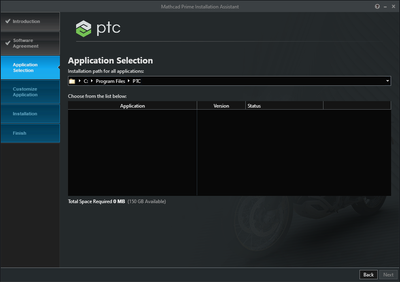

no application is available here, and it stays at this step forever.
The topic of this thread is on Mathcad 15, not Prime.
You should rather be looking at https://community.ptc.com/t5/Mathcad-Installation/Step-by-Step-Installation-Procedure-for-Mathcad-Prime-6-0/m-p/705277#M11. (which https://community.ptc.com/t5/Mathcad-Installation/Step-by-Step-Installation-Procedure-for-Mathcad-SUA-and-Academic/m-p/705278#M12 referred you to)
Take good notice of: "download the software and execute/run  pim_installmgr_mathcad.exe and run it as an Administrator."
